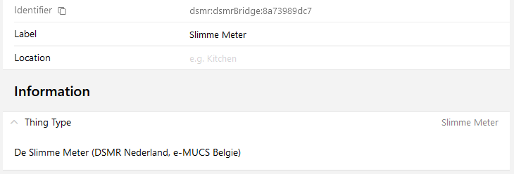

Hi everyone,
I’m running OH 4.1.3 on a PI4B.
Last week I got a digital smart meter (electricity, gas and water)

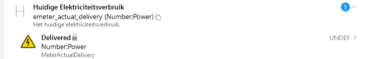

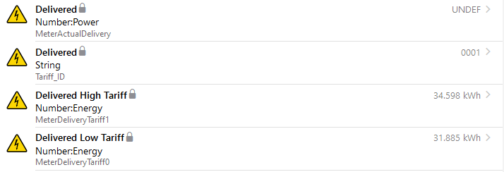

I did install the Generic DSMR add-on. But when I want to readout the ‘emeter_actual_delivery’ value it is giving me UNDEF.
The rest of the readings are working properly (see figure)
Probably they will be something wrong but so far I couldn’t make it working. Anyone who got already the same problem?

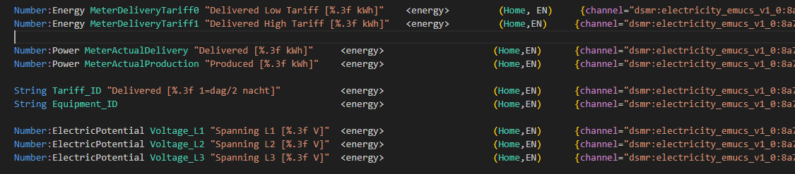

Appendix: in Home.Items I did following declarations:

ActualDelivery and ActualProduction unit should be Kw, not Kwh to start with.
Maybe that’s the problem.

Dear Nico,
It works!!! Thank you so much for solving this problem. I overlooked this one and forgot to set it to the correct unit. Sometimes copying is not always the fastest way to go
I’m really happy it finaly works!!!
