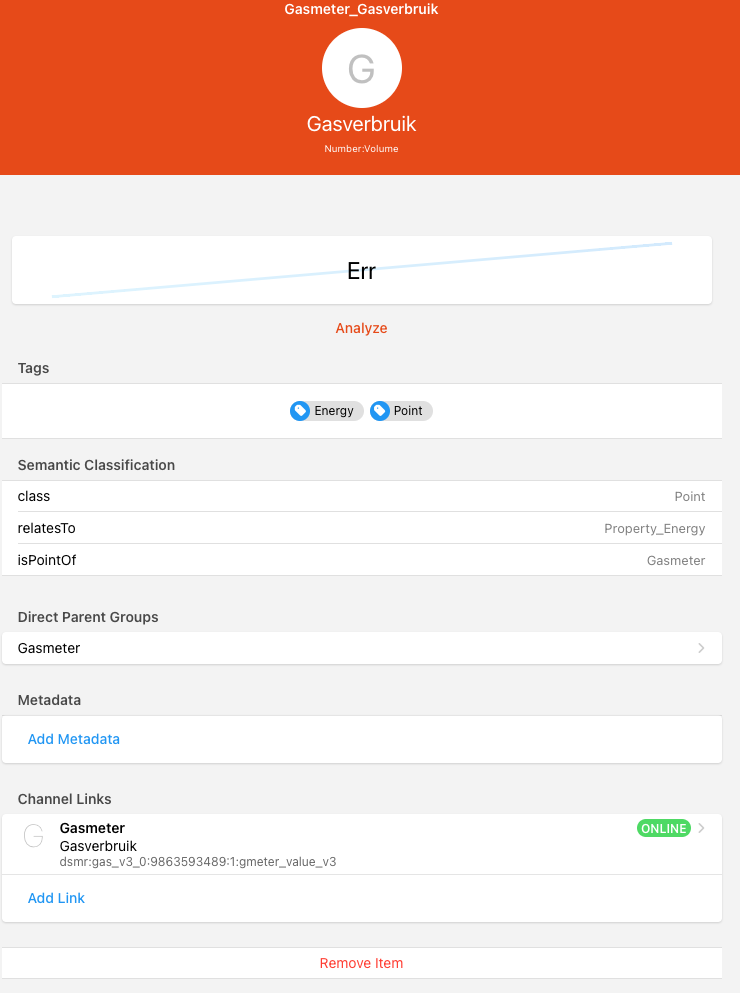

    I have installed and configured the DSMR 3.0 binding for use with my Slimme Meter (in the Netherlands).
    This was a succesful setup. Then I added things based on the dsmr:dsmrBridge Smart Meter Bridge which were autodetected by the ‘Scan’ options.
The Bridge is Online.
The following Things were created:
  1. Algemene DSMR Meter - dsmr:device_v2_v3
  2. Elektriciteitsmeter - dsmr:electricity_v3_0
  3. Gasmeter - dsmr:gas_v3_0
the persistence database shows (at least to me) correct information for Things 2 and 3. I don’t know what Thing 1. is for though.
I can see all item values on my Dashboard except the item ‘Gasmeter_Gasverbruik’
The problem is that the item ‘Gasmeter_Gasverbruik’ shows ‘Err’ while the values in the persistence table are ok as far as I know. (the items for Elektriciteitsmeter are correctly shown)
The item is configured as:
class Point
relatesTo Property_Gas
isPointOf Gasmeter
Channel link to Gasmeter - Gasverbruik - dsmr:gas_v3_0:xxx:1:gmeter_value_v3
How can I fix this? I am really new to OpenHAB. I had my meters configured in Domoticz where they showed correctly. But I like the OpenHAB software so I’d like to move to this platform.
Your help is greatly appreciated!
Kind regards,
Erwin

The binding seems to work fine. The item Gasverbruik shows the correct value:
Screenshot 2021-02-02 at 20.55.32
However the page where my Cell is displayed it says ‘Err’. This is the yaml:
component: oh-label-cell
trendItem: Gasmeter_Gasverbruik
action: analyzer
actionAnalyzerItems:
- Gasmeter_Gasverbruik
item: Gasmeter_Gasverbruik
title: Gasverbruik
stateAsHeader: true
expandable: false
Do have any metadata set - in particular state description?
I believe the ‘Err’ is coming from the item.DisplayState due to the pattern being wrong.
This is what my Item looks like. Seems no metadata set. I really am to new to this all to see through how this thing/item/persistence → Display on screen is organised. Thank you for helping. I really appreciate this.

The binding doesn’t seem to handle the gas reading properly. The data is delivered by the meter in a none-standard way and this is not handled correctly. So the data in the binding is threated as a Number type, while the definition in the binding is Number:Volume. As a consequence the UI, by default, creates an item as Number:Volume. This results in the error in the UI because the actual data in the item is a Number.
If you manually create an item of type Number it should display the value correctly. In the mean time I’m going to see how to fix this in the binding.
Thanks for your response. Can you explain how I do this? If you need help to fix the binding by supplying information on the meter and or raw data, please let me know.
I do have a persistence table with the gasmeter entries. So that seems to work.
In the UI if you open the item and edit it. I think you should be able to change the Type. I expect it to be Number:Volume and change it to Number.
From you log I already have the raw data. So I can already test it.
Thanks Hilbrand. That did the trick!
