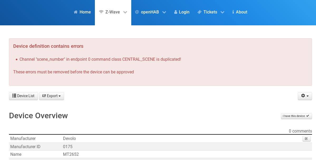

I am completing my openHAB 2.3.0-1 setup and stumbled accross a duplicate channel id when setting up a devolo MT2652 Scene Switch. The channel “Scene Activation” as well as “Scene Number” have the same idents: zwave:device:9a9aac85:node13:scene_number

Correct. It seems that ESH added a check (rightly so!) to not instantiate channels at all if there were duplicates. I guess in the past it instantiated one or other, but now it rejects both (and may even reject the whole thing - I forget now).
Yes - if both CENTRAL_SCENE and SCENE_ACTIVATION are supported, then we should use CENTRAL_SCENE as it’s the newer command class that is better designed for working with controllers / smart-home software.
Done (scene_number channel under SCENE_ACTIVATION has been removed). @tc77, just wait for a new build, update your binding, and delete/rediscover the Thing to pull in the changes.
