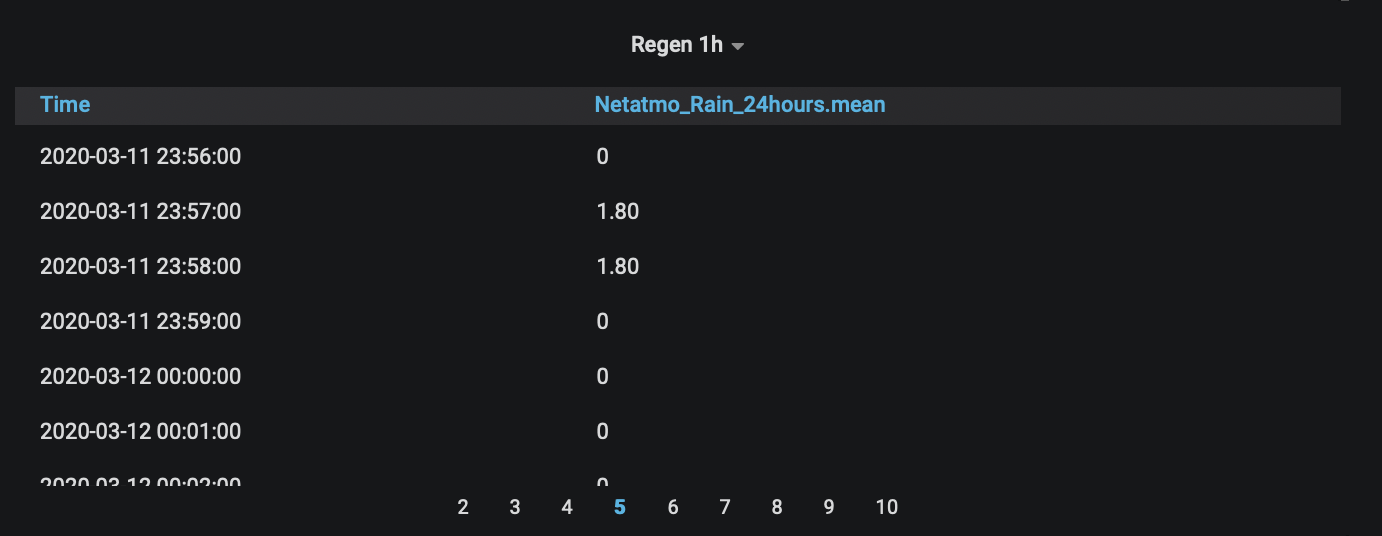

Hello @rossko57 - thanks for your reply.
I did some screenshots in Garfana of the item.
It seems the issue start to occur on 16. Feb 2020 only. Earlier records are correct as you can see in the screenshot below. I remove ‘0’ values in this output:
When I fill the empty records with ‘0’ it looks good for old records (before Feb 16) - only at 0:00:00 the entry is stored in the database.
When I check for recent entries, I see they are duplicated at 23:59:00 and 00:00:00, else is ‘0’
As you can see, the values are always a duplicate :

Problem still persist, even with the updated Cron Time.
The value is still written twice - at 23:58:00 as per strategy, but also one minute before at 23:57:00.
Any clue what could trigger this behavior suddenly?

I’m still struggling with this issue. I renamed the item for testing but still see duplicates in the records with 1sec time difference.
Today I discovered this is happening as well for the 1hour item statistic randomly. (see picture)
I really have no clue what the trigger is for this strange behavior, nor how I can debug it.
