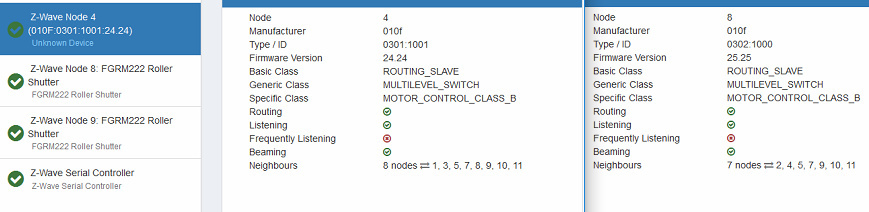

Understood … but in my case, it is just another Reference (Type:Id), because the firmware matches that of this entry:
http://www.cd-jackson.com/index.php/zwave/zwave-device-database/zwave-device-list/devicesummary/413
And I just realized there are indeed multiple Type:Id entries possible for the same DB entry. So maybe I can add 0301:1001 to the 2 existing entries of 0302:1000,0302:3000 ? Seeing that they have the same firmware version (24.24), I am hoping this would be OK. Thoughts?
Ok - simple then. Just add the type:id to the database.
Absolutely - this is perfectly ok.
