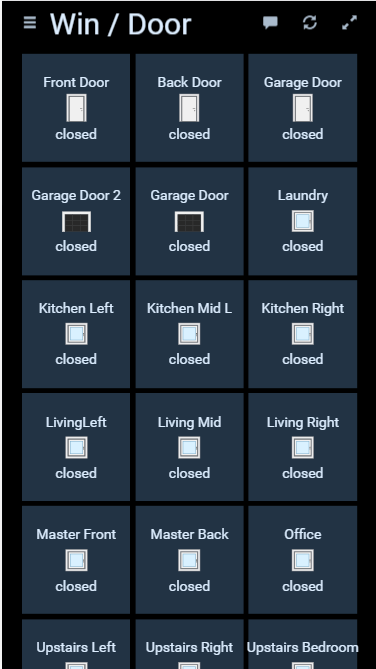

Here are some screen shots. The first screen are the group

This is what I have in the bottom right of my main HABpanel dashboard:
Seems to work great. The garage one is the only one I have currently configured and working correctly. I have it tied to my MyQ binding, but would like to use this with the DSC Alarm binding instead. Still have more work to do.

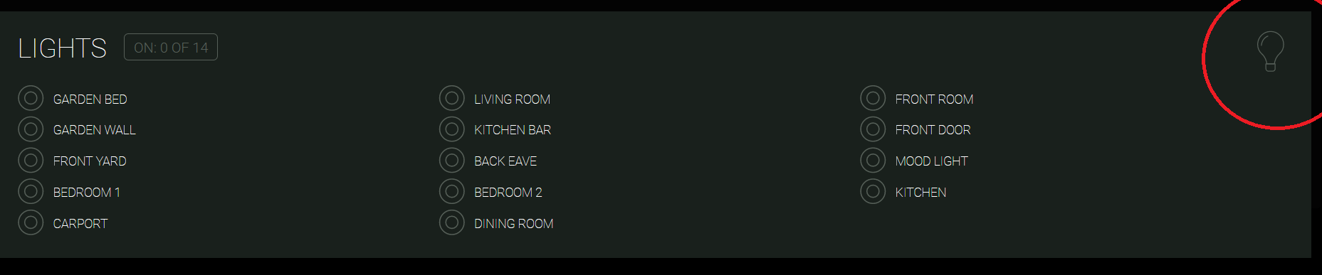

is there a method to change an SVG icon to be on/coloured , if an item state = ON within HabPanel?
I have a picture of a light globe, it would be great to illuminate this if any of my lights are on as an easy way to see if something is on quickly.
See attached
Thanks!
