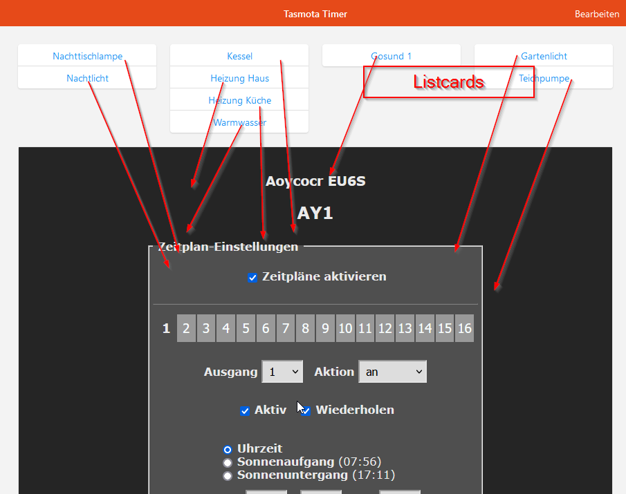

I have several smartplugs flashed with Tasmota. I want to set the timers using OH3. My idea is to use a web frame card, to browse the URL that leads to the tasmota timers configuration page. e.g. 192.168.165.152/tm?. It works without any problems.
The goal, however, is to display different URLs (smartplugs) in the web frame card, at the push of a button.
There are several list cards above the webframe card.
Every ListItem is a smart plug.

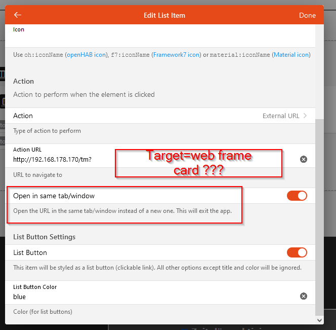

The action to perform when the element is clicked, is External URL
Is it possible to define the web frame card as target for the “External URL”?
Oor is there another idea to realize that?

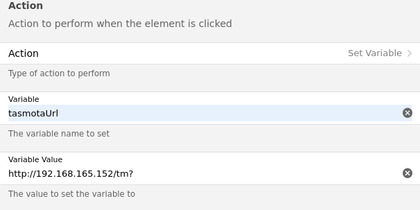

You don’t want to use the URL action here. To the best of my knowledge there’s just no mechanism for specifying which frame to target with the link.
There is, however, a simple solution. Use the variable action. Give each of the list items the action to set a variable of whatever name you want (for example tasmotaUrl) to the timer page you want to control::
Note: you will have to select advanced options at the top of the config dialog to see the Variable and Variable Value properties.
Then all you have to do is set the source URL on the web frame to that variable using the vars object:

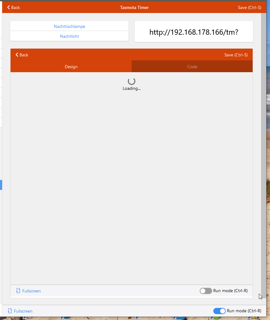

But the fundamental problem remains. The buttons do not work in regular operation. The content of the webframe card does not change.
And a new problem has arisen. When I use the combination: Edit - run mode - save (several times), the whole OH window is displayed in the webframe card ???
The core of the problem must lie in the setting of the variable and not in the webframe card. Even in this minimal setup, the variable is not displayed in the LabelCard.
