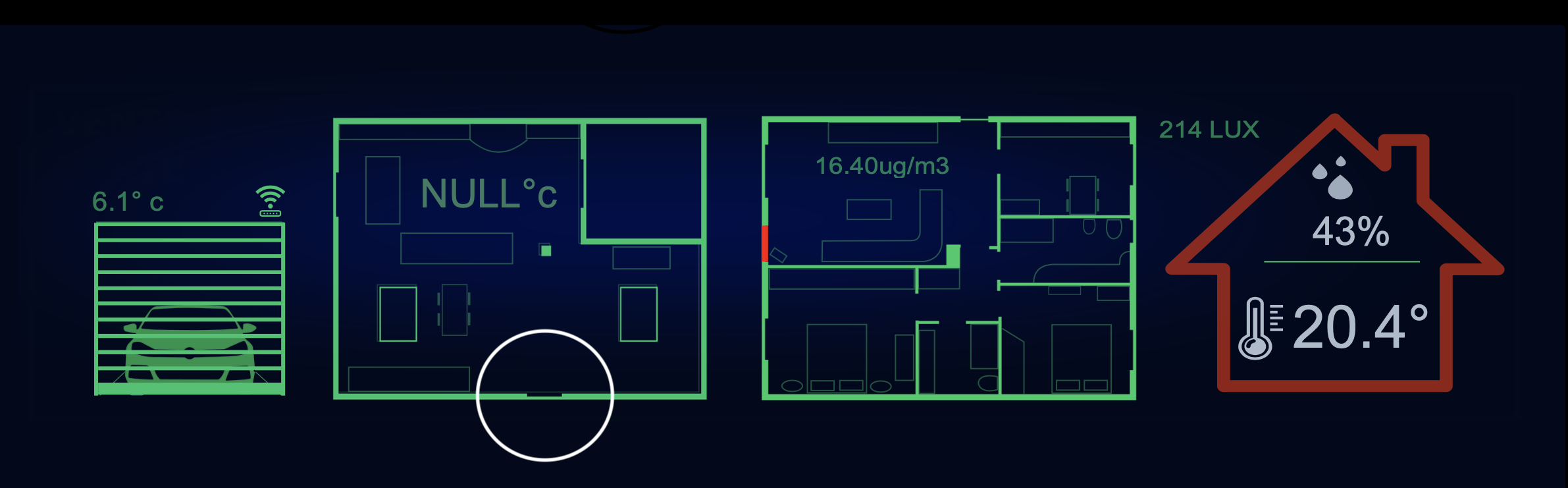

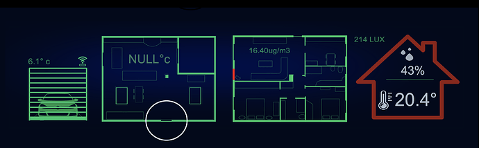

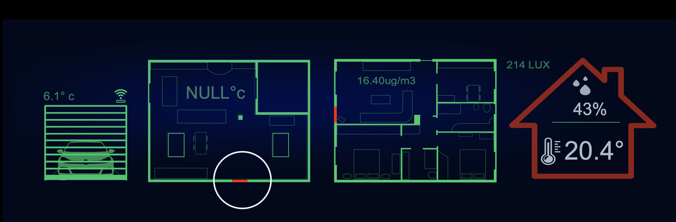

Basically it was a .png file representing a home plan and which dynamically changed the colors of windows and doors in order to show which ones were closed/opened.
As you can see from the screenshots below, the highlighted door passes from red (OPENED):
…to CLOSED:
