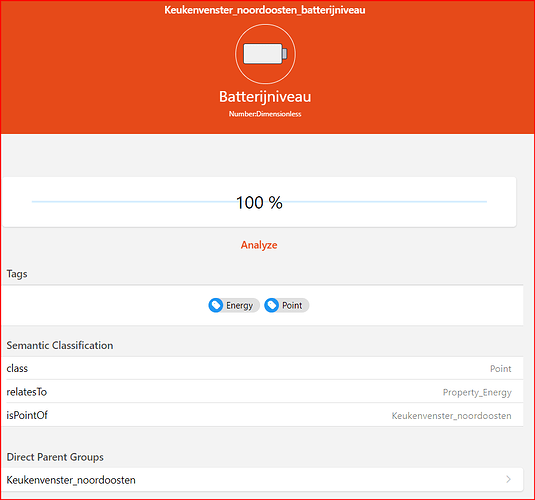

If the battery level is 100 %, why is the icon an empty battery?
Or am I wrong in understanding that the icon is dynamic?
You probably haven’t set the unit metadata on the Item to %, so it’s sitting the value as ONE which is a simple ratio (i.e. a value between 0 and 1, as opposed to between 0 and 100.
I hadn’t set the unit metadata indeed. I’m not sure how to do that correctly…
I tried with and without quotation marks, but no luck:
Does it have to do with the Dimensionless
ness?
