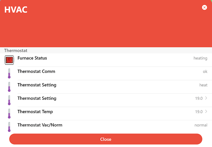

No matter what I always see the default icon:

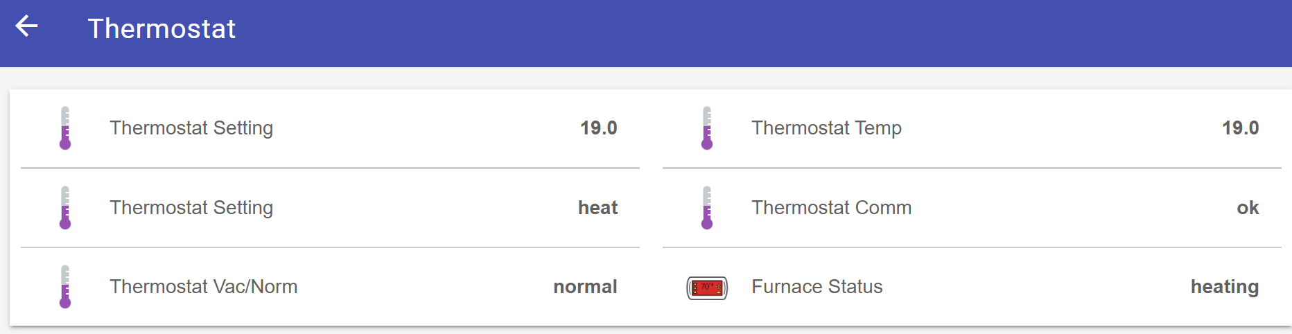

I just checked my old sitemap and it seems to work there:
Red is heating and blue is cooling.

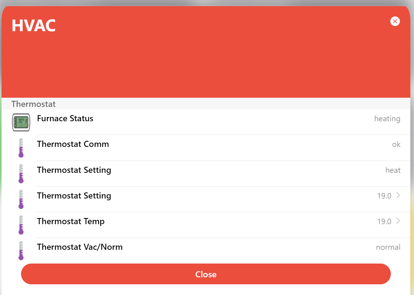

What I did to get to work was open the Settings → Model find the item that from the text file and then press the Add Metadata button. As @rlkoshak suggested I added a Default List Item Widget. I selected Show Advanced and checked the Icon depends on state box and Saved.
Then it started working:
Yippy. Thanks All.
