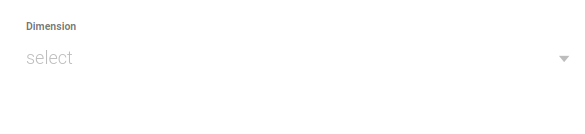

maybe i did it wrong but it think the Dimension Drop-down menu is for that
But it don’t allow to add some own definition.

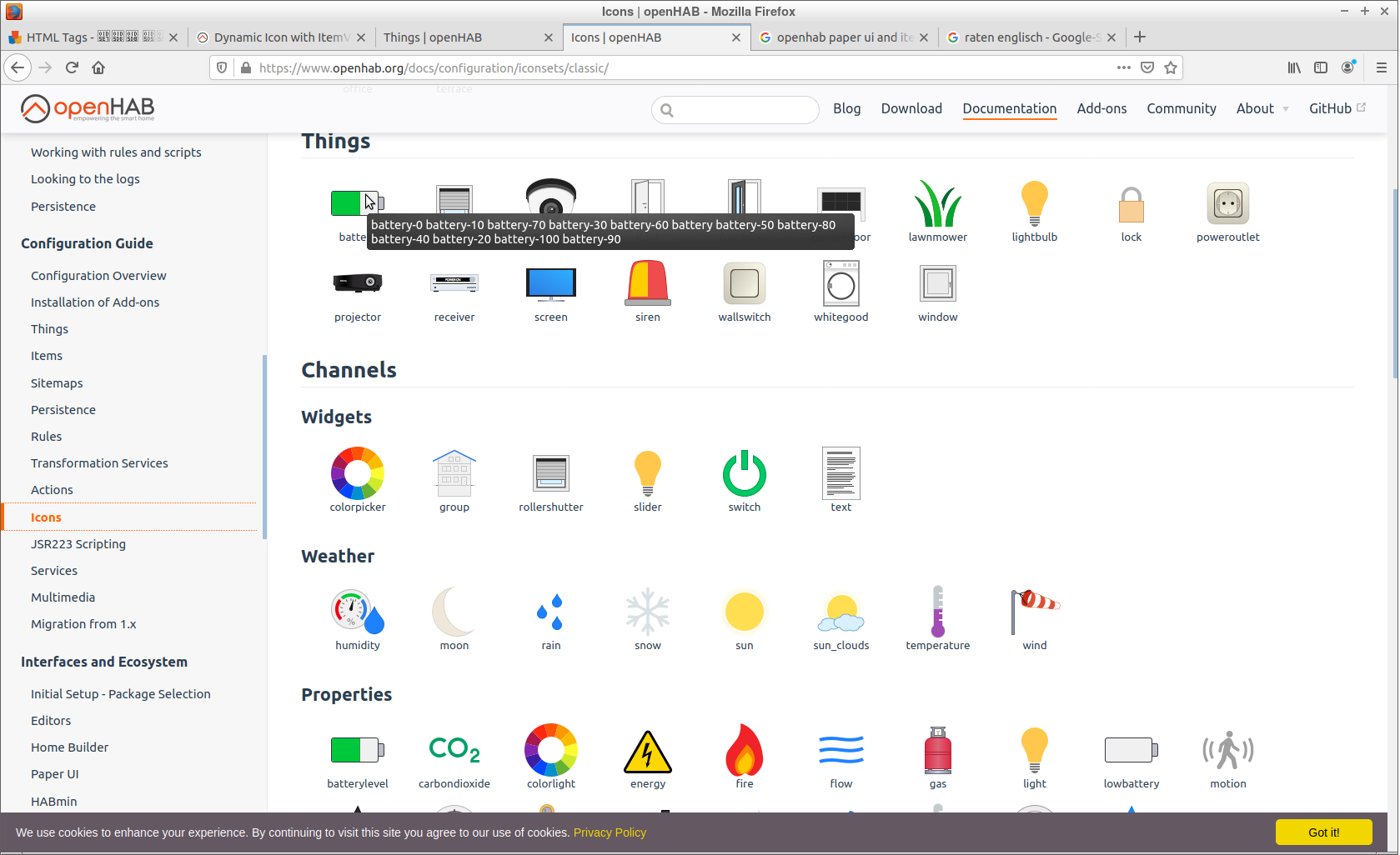

I suppose you might check the filename.
I don’t see any Battery battery_item Battery-level or batterylevel icons in the default set, and now you’ve told us you’re not using a custom icon set.
https://docs.openhab.org/v2.1/addons/iconsets/classic/readme.html
Hover for image names
i use this one.. i also got the soundvolume icon from there..
i double checked the names…
Well, batterylevel does not appear in this set
Humour me and try with icon set battery

div class="col-xs-3"><span ><widget-icon iconset="'eclipse-smarthome-classic'" icon="'battery-<battery_item>'" size="25" /></span></div>
Thats spacial? Who can correct the doc?
Is this how it usually works in HABpanel? Seems odd. In other UIs you just give the root filename for iconset e.g. battery, and its the iconpicker at OH that supplies battery-20.png instead.
The icon name is batterylevel
And it does indeed work fine. I´m using it on my sitemaps.

It’s an old docs page. From what @Kim_Andersen says, both battery and batterylevel icon sets exist now.
