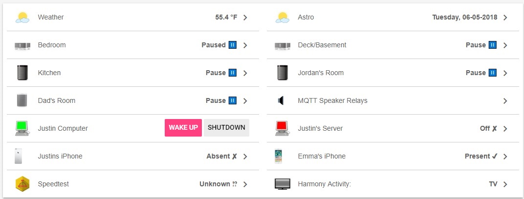

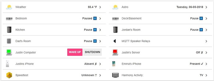

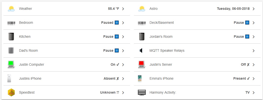

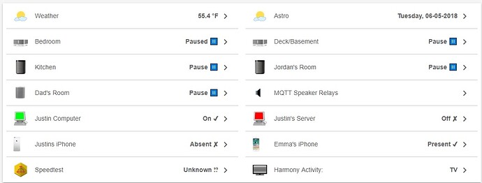

so i have a question and wondering if it is possible thought the sitemap, how or if it can be achieved.
This is my current setup
current%20setup
I would like it to look like this…
proposed%20setup
This is the tricky part…
I would like to have the icon shown to correspond to the switch status of one switch item ( my computer to say if it is on or off)
Switch Presence_Justin_Computer “Justin’s Computer [MAP(active.map):%s]” (gBedroom, gComputers) {channel=“network:pingdevice:Justin_Computer:online”}
Then use another switch mapping as the actual control to wake/shutdown my PC…
Switch MPCONOFF “My PC” (gComputers, gMasterBedroom) [“Switchable”]
Does anyone know if this is possible or how this would be achieved?

Thanks for the reply, but I actually figured it out using rules a completely new item:
If anyone was wondering, this is how I did it… Sorry if it is bad explination…
I created a new item that will be associated with a number, that number in turn will change the icon depending on which state it was selected/in.
