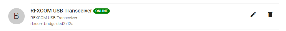

This is the binding:
If you want it to be a roller shutter and the channel supports that, you need to use a Rollershutter Item, not a Switch.
If the binding doesn’t support linking that channel to a Rollershutter, a Switch is all you have available because you can only send ON and OFF commands to the channel.
