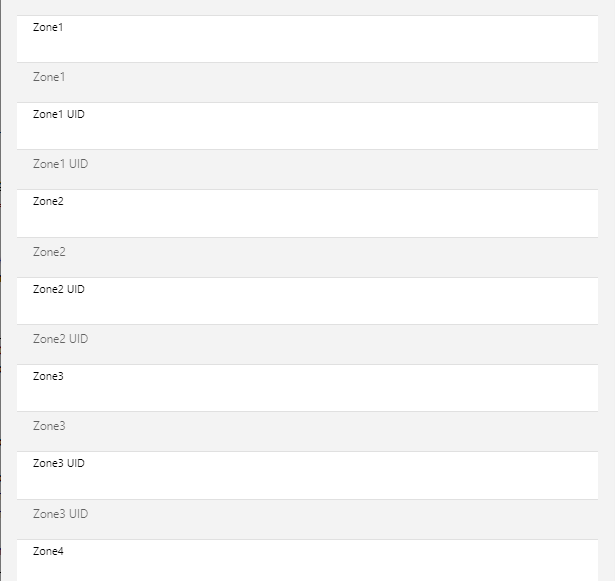

Is there a way to add an array item when defining props in a widget? For example I have this items below and I want to have like an array/list where I can add any number of items inside it:
I only want to achieve this through the widget and not from a rule.

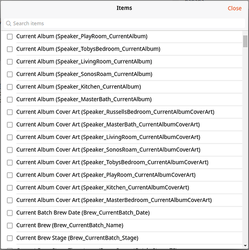

In most situations, the group and tag options mentioned above are your best solutions, especially if you are then using an oh-repeater to get detailed api data about items. However, there is a built-in solution for more general arrays in parameters: the multiple property.
For example, the paramter:
    - name: itemArray
      label: Items
      type: TEXT
      context: item
      description: A list of items
      multiple: true
Will open up the item picker with checkboxes:
which allows you to selecte multiple items and the returned property just uses basic array indexing: props.itemArray[1].

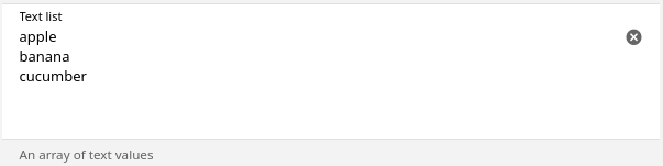

The same is actually true for a text field as well. Adding multiple: true turns the text parameter input from a simple input box to a multiline textarea input and each line is an element in the returned array.
    - name: textArray
      label: Text list
      type: TEXT
      description: An array of text values
      multiple: true
And props.textArray[1] returns banana.
