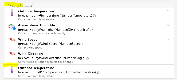

I tried creating a channel with an unknown channel group Id in the secret hope that an error message would give me a clue, but it did not fail. The UI simply shows the channel with a group heading that is very small because there is not text for it:
Having channel group definitions present in the XML file that have no channels associated also works, and they are not displayed in the UI either, but it feels very wrong to clutter the XML definition with almost 400 channel groups…

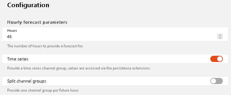

But in order not to clutter the system, I made those optional via a configuration option:
