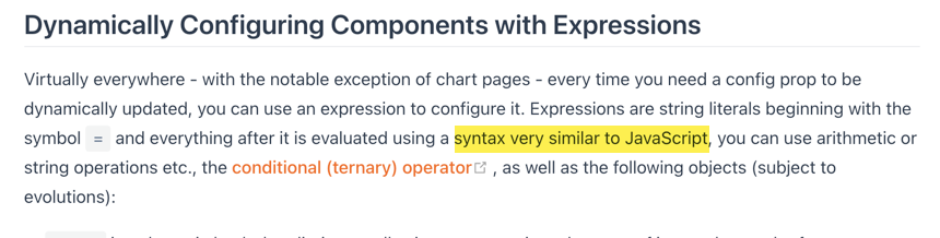

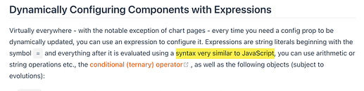

Looking through the examples in the forum I was not able to get a clue what sort of language spec the dynamic configuration language has.
Here it is stated:
Which is rather fluffy!
Is there a document that is more specific?

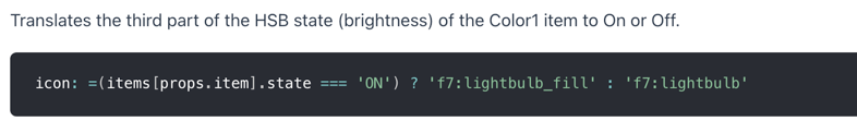

In the documentation I read the following:
I have following yaml definition:
- component: f7-col
    default:
      - component: oh-icon
          icon: = (items[props.rsItem].state === undefined) ? 'oh:rollershutter' : 'oh:rollershutter-' +items[props.rsItem].state
          height: 140
for the icon assignment I get:
Nested mappings are not allowed in compact mappings at line 64, column 33:
                          icon: = (items[props.rsItem].state === undefined) ? '…
I get the same error message also when copying the sample above.
My questions are:
What does the error message mean, what is the cause?
How can I fix this?
The working solution is:
tooltip: "= props.rsItem === undefined ? 'oh:rollershutter' : 'oh:rollershutter-' + items[props.rsItem].state"
I am not clear about why and why not I just found out by try and error.
No clue when it has to be quoted and when not?
https://gordonansell.com/nested-mappings-are-not-allowed-in-compact-mappings/
Basically when you have a : in the value you have to add the quotes, since it’s also the separator between the field name and the value.
