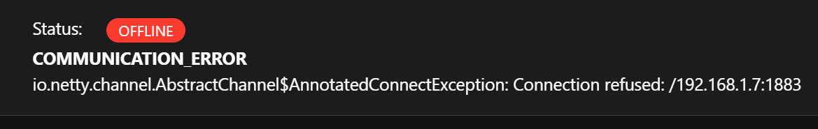

Lately it has started going offline and I’m at a loss as to why.
I have enabled trace logging for mqtt:
Starting out, the connection to the broker, aka the fan itself, is offline:
Then, after power cycling the fan, it goes online, and is controllable through the sitemap/rules.
It will stay online for just over an hour, then drop offline again, with status as above. The logs does not say much. While online:

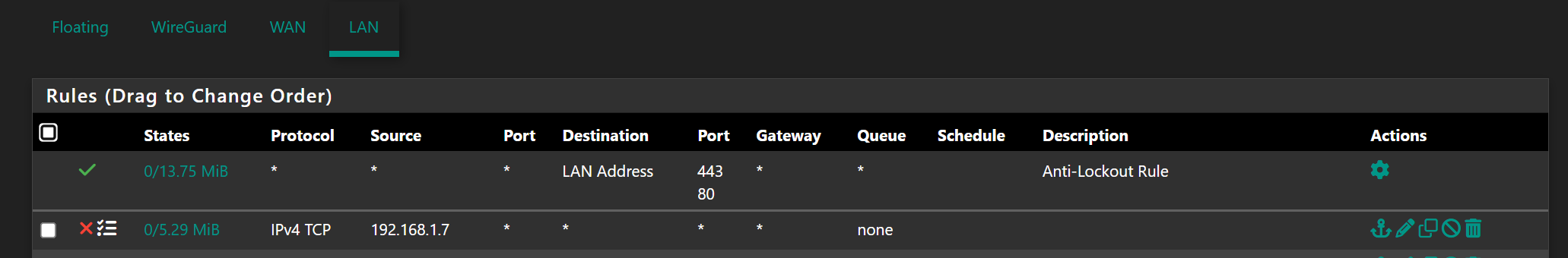

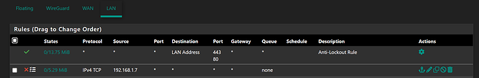

I finally figured it out.
The Dyson fan is calling home, punching a hole in the firewall and disables local control.
Denying the fan access to the internet fixes the issue.
Adding this DENY rule for the fan IP 192.168.1.7 does the trick:
Stays Online now. :slight_smile:
