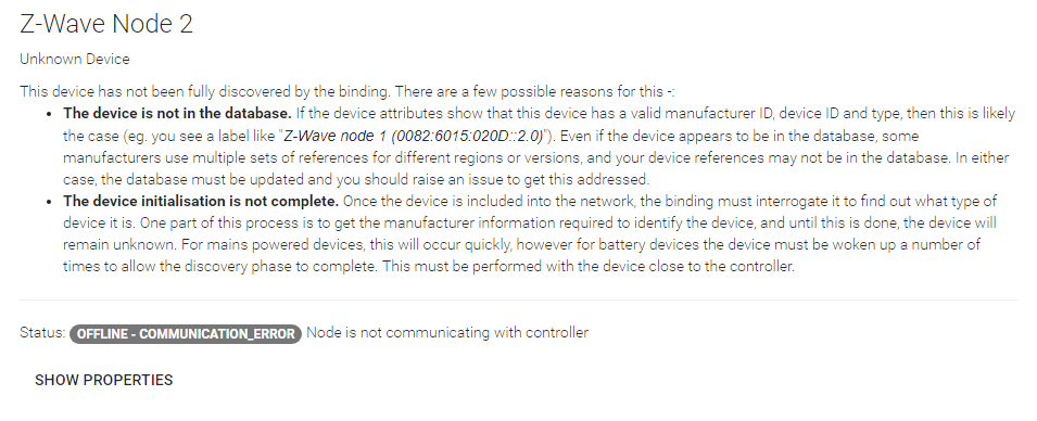

But now I have a new problem. Only 1 switch is found when scanning and when I add it, it sometimes says it’s online. But I can’t link channels. All I see is:

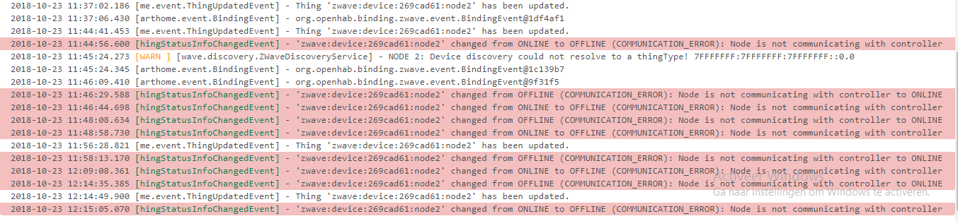

This is what my :9001 says:
I tried switching on and off multiple times, I tried removing the binding and starting over. But I have no idea what I can do next.
