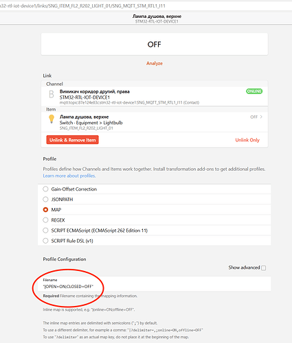

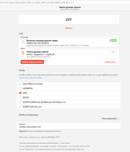

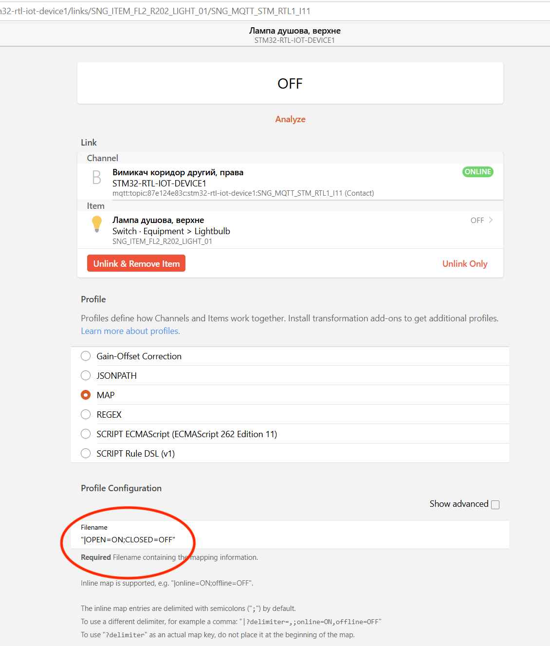

Link configuration:
Is it bug or I config it in wrong way?
Do not type in the quotation marks in there.
It should look like this
Expression without quotes didn’t change anything.
It would set the state of the linked item, not send a command to it. But you want it to send a command to it? Then this particular config won’t do that.

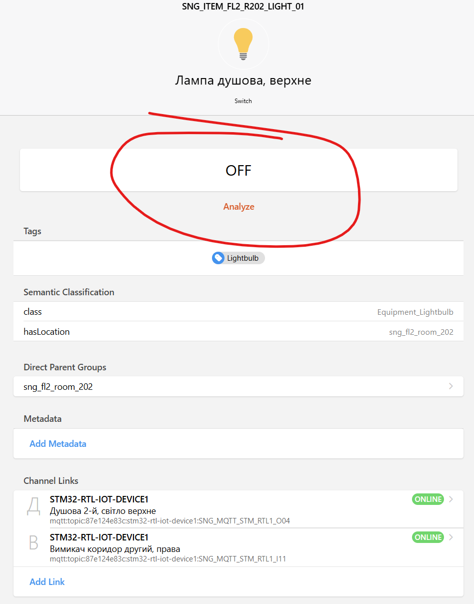

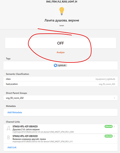

I have changed mqtt:contact to mqtt:switch - no changes, light switch as readonly string.
I updated mqtt channel with postCommand: true. After that I see in events.log expected log but no real command in MQTT. I have added to MQTT channel commandTopic: FAKE_TOPIK and after that all works as expected.
It looks like a link switch item to readonly mqtt channel convert swith to read only switch and do not send commands even item has another link with command channel.
Is it bug or feature?
