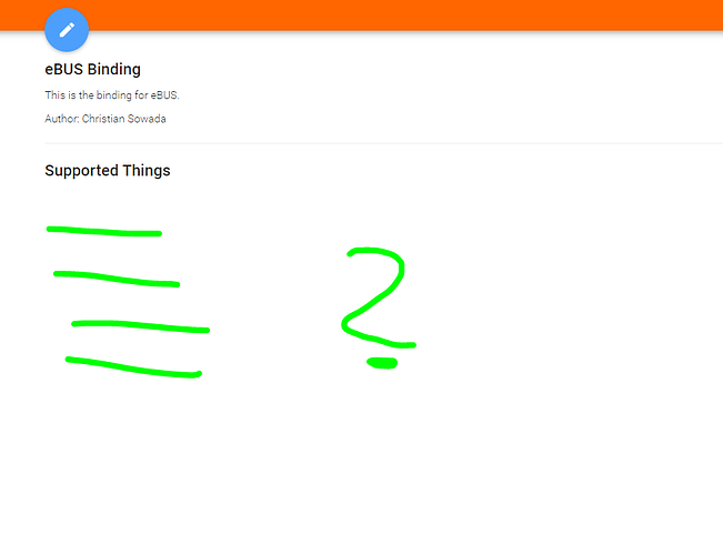

Ebus 2.0 binding does not show up in Paper UI
I’ve copied the *.kar file into the addons folder but it doesn’t appear in the paper ui.
What did I do wrong?

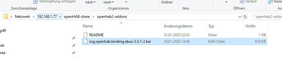

When you say “addons directory” Where exactly is that? Can you do an
ls -la path_to_addons
and then show the output? That should help to see if there is a permission problem or the file was corrupted during download/copying.
How did you copy it from windows to the raspi? That may have introduced a corruption possibly.
I hope I this is what you asked me for…???
[16:50:30] openhabian@openhab:/usr/share/openhab2/addons$ ls -la
insgesamt 632
drwxrwxr-x+ 2 openhab openhab 4096 Jan 19 16:51 .
drwxrwxr-x+ 4 openhab openhab 4096 Jan 14 21:07 ..
-rw-rw-r-- 1 openhabian openhabian 632318 Jan 18 13:44 org.openhab.binding.ebus-2.5.1-2.kar
-rw-r–r-- 1 openhab openhab 70 Jan 12 22:53 README
[16:51:11] openhabian@openhab:/usr/share/openhab2/addons$
I just made a networkdrive on my windows machine to the raspi an copied there…

the last time I instaled it I had various items to select under supportet things. Where are they now ?

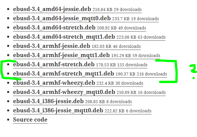

do I understand it right that I need to run ebusd to get everything into the binding?
which version should I use?
I’m using buster so strech is the one to choose. But with or without mqtt1? Or can I use the mqtt1 version anyway?
Sorry gents for asking such rookie questions you all probably cant read anymore :slight_smile:

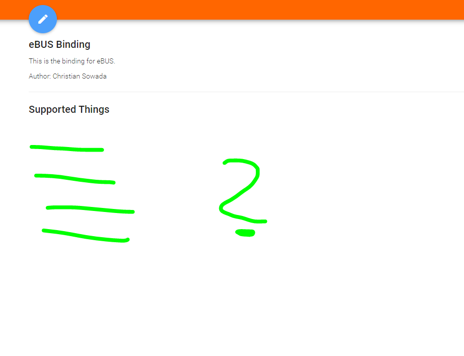

Now the ebus binding which was visible before is gone again! WHY the f***???
You can use ebusd (though there is currently a bug causing it to stop for a couple of us, or you can use the serial port connection or raw network device direct connection instead. So you don’t need ebusd. If you do use ebusd it wont matter whether it has mqtt or not I don’t think so either should work. No idea why things aren’t showing up under supported things.
[solved] Thanks everyone for trying to help me!
In the end suddenly all the ebus stuff came back in the ebus binding. Maybe due to a simple sudo uodate /sudo upgrade this morning. Cant`t tell 100% if that was the reason but the main thing is… it is there :slight_smile:
Hope I manage to get data out of my heating system!
