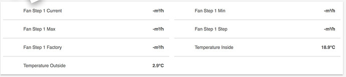

A problem occurs when polling a sensor that is not connected to the system if its datatype is EXP (float). In this case, VRC 700 returns FF FF FF 7F, a value that can not be converted into float due to excessive exponent (according IEEE 754). Another Vaillant special case :frowning: . On the other hand, this should be the last one for this configuration. :slight_smile:
00:13:24.811 [DEBUG] [de.csdev.ebus.core.EBusController    ] - Succesful send: FF 15 B5 24 06 02 00 00 00 9D 00 27 00 08 00 00 9D 00 FF FF FF 7F 54 00
00:13:24.817 [ERROR] [de.csdev.ebus.core.EBusControllerBase] - Error while firing onTelegramReceived events!
java.lang.NumberFormatException: null
        at java.math.BigDecimal.<init>(BigDecimal.java:494) [?:?]
        at java.math.BigDecimal.<init>(BigDecimal.java:383) [?:?]
        at java.math.BigDecimal.<init>(BigDecimal.java:806) [?:?]
        at java.math.BigDecimal.valueOf(BigDecimal.java:1274) [?:?]
        at de.csdev.ebus.command.datatypes.std.EBusTypeFloat.decodeInt(EBusTypeFloat.java:43) [213:de.csdev.ebus.ebus-core:0.9.16.SNAPSHOT]
        at de.csdev.ebus.command.datatypes.std.EBusTypeFloat.decodeInt(EBusTypeFloat.java:1) [213:de.csdev.ebus.ebus-core:0.9.16.SNAPSHOT]
        at de.csdev.ebus.command.datatypes.EBusAbstractType.decode(EBusAbstractType.java:100) [213:de.csdev.ebus.ebus-core:0.9.16.SNAPSHOT]
        at de.csdev.ebus.command.EBusCommandUtils.decodeValueList(EBusCommandUtils.java:374) [213:de.csdev.ebus.ebus-core:0.9.16.SNAPSHOT]
        at de.csdev.ebus.command.EBusCommandUtils.decodeTelegram(EBusCommandUtils.java:426) [213:de.csdev.ebus.ebus-core:0.9.16.SNAPSHOT]
        at de.csdev.ebus.service.parser.EBusParserService.onTelegramReceived(EBusParserService.java:94) [213:de.csdev.ebus.ebus-core:0.9.16.SNAPSHOT]
        at de.csdev.ebus.core.EBusControllerBase$2.run(EBusControllerBase.java:102) [213:de.csdev.ebus.ebus-core:0.9.16.SNAPSHOT]

Here the csv file. It is for the Wolc CWL Ventilation unit
3c.wolf-cwl-excelent-300.csv
Here the actual json file
https://drive.google.com/open?id=1GT0jN_aTPs77iC1qsvnDGVt4szjVVH13

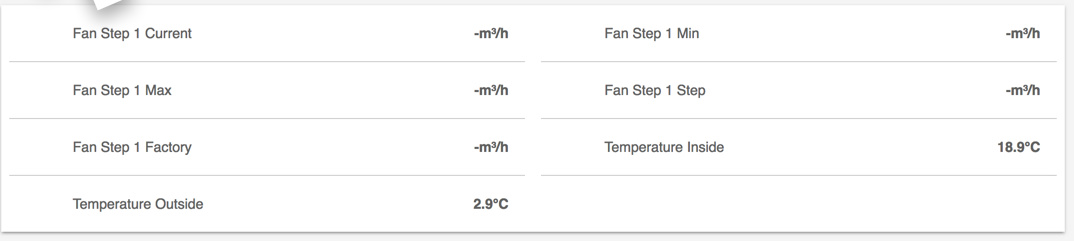

Unfortunately the values for fan steps are not coming over:
2018-01-27 15:35:12.006 [INFO ] [hab.binding.ebus.handler.EBusHandler] - Poll command "ebus:cwl:f19be90f:3C:cwl_ac_fan-step-3#cur" with "FF 3C 40 02 50 03 99" ...
2018-01-27 15:35:12.935 [INFO ] [hab.binding.ebus.handler.EBusHandler] - Poll command "ebus:cwl:f19be90f:3C:cwl_ac_fan-step-2#cur" with "FF 3C 40 02 50 02 98" ...
2018-01-27 15:35:14.999 [INFO ] [hab.binding.ebus.handler.EBusHandler] - Poll command "ebus:cwl:f19be90f:3C:cwl_ac_fan-mode#fan-mode" with "FF 3C 40 22 01 01 97" ...
2018-01-27 15:35:15.230 [vent.ItemStateChangedEvent] - WolfCWL3C_CwlAcFanModeFanMode changed from NULL to 1
2018-01-27 15:35:16.899 [INFO ] [hab.binding.ebus.handler.EBusHandler] - Poll command "ebus:cwl:f19be90f:3C:cwl_ac_fan-step-1#cur" with "FF 3C 40 02 50 01 9B" ...
2018-01-27 15:35:21.034 [INFO ] [hab.binding.ebus.handler.EBusHandler] - Poll command "ebus:cwl:f19be90f:3C:cwl_ac_temp-ouside#temp-ouside" with "FF 3C 40 22 01 08 9E" ...
2018-01-27 15:35:21.233 [vent.ItemStateChangedEvent] - WolfCWL3C_CwlAcTempOusideTempOuside changed from 2.9 to 5.4
2018-01-27 15:35:22.761 [vent.ItemStateChangedEvent] - HMVentOGOutside changed from 12.30 to 12.10
2018-01-27 15:35:23.994 [INFO ] [hab.binding.ebus.handler.EBusHandler] - Poll command "ebus:cwl:f19be90f:3C:cwl_ac_temp-inside#temp-inside" with "FF 3C 40 22 01 07 91" ...
2018-01-27 15:35:24.177 [vent.ItemStateChangedEvent] - WolfCWL3C_CwlAcTempInsideTempInside changed from 18.9 to 22.5
2018-01-27 15:35:26.964 [INFO ] [hab.binding.ebus.handler.EBusHandler] - Poll command "ebus:cwl:f19be90f:3C:cwl_ac_fan-step-0#cur" with "FF 3C 40 02 50 21 BB" ...
Quick info, your command must have 2 bytes. You often have only one byte like “40”.
what should I put for this command value?
40 50.
does the default value for get/set overwrite this value?
