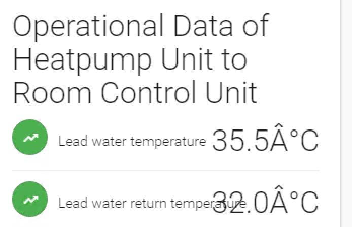

i have one question, with all values i have a character and fonts do not allign
is this something that needs changing in openhab or in the binding ?
thanks in advance for a hint
Erik
You should use an editor that supports UTF-8
Hi
I have This behavior with all screens, not only the ones that i created
The values are correct..
Reg
Erik
