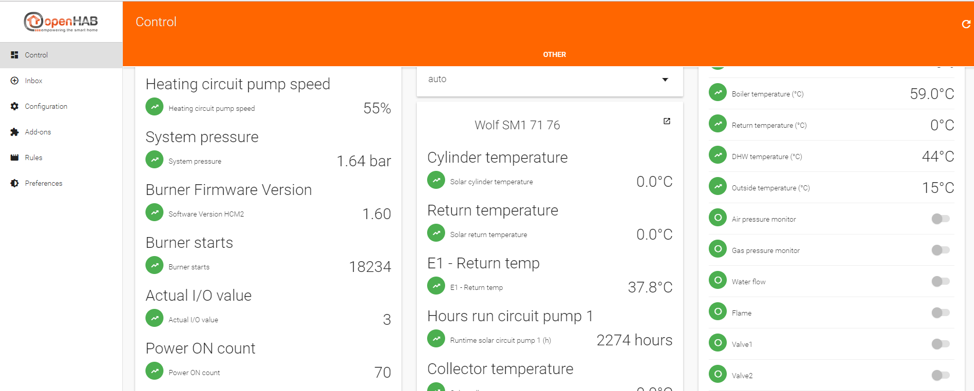

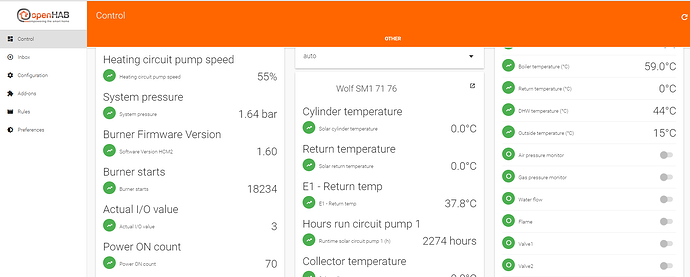

Hey @csowada, thanks. I’ve just downloaded it and giving it a try. A small hint needed - what are master and slave HEX addresses? Is it any value (as long as free, which I need to guess) or must be specific to Vaillant (mine is vc246)?
I tried with examples you gave for Wolf 71/76 and so far binding doesn’t see values from ebus:
(not yet in debug, as probably I have some major configuration problem which you can spot without debug)

oh yes , it works like a charm comparing to what I experienced before :wink: [update] I was not specific enough - yes, both getting values and polling work good and take immediate effects after adding items.
Maybe I’m getting my comments too early and too optimitstic but before after +/- 10-15mins binding used to stop working and reconnect of usb was the only resolution. Now it is stable so far for half an hour, fingers crossed! Great news about the fix for setting value, this is very much needed.

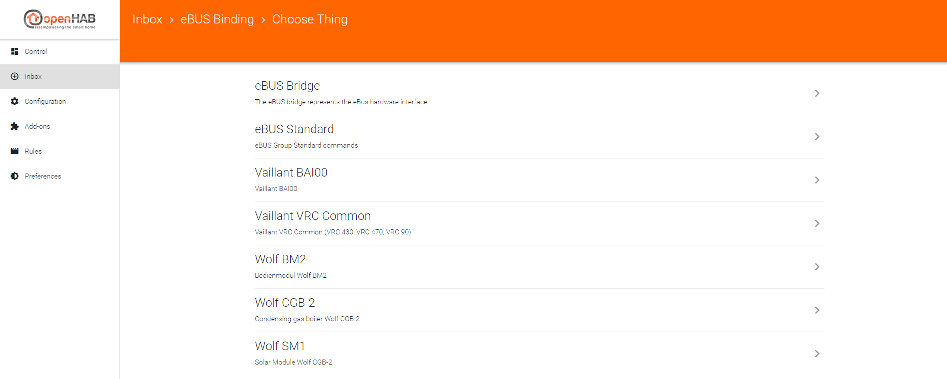

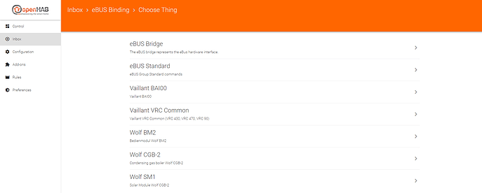

I am experiencing however problem with BAI00 thing definition - when trying to add it via PaperUI I’m getting 500 Internal Server Error (no input in openhab.log), I tried different browsers and I restarted openhab. Error is immediate after pressing save/OK.
at the same time playing with VRC Common settings in paperUI (and adding channels/items) works correct. Any idea what could be wrong?

I already fixed the issue with BAI00, HC precision is also easy to fix.
