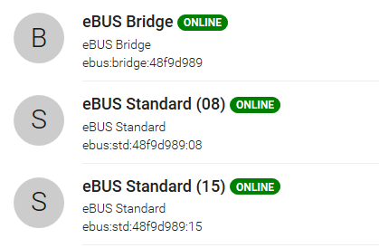

Autodiscovery finds nothing, so I’ve to add Things manually :frowning:

It’s really crazy, after I deleted now the ebus-bridge an added new, now something was found automatically und I get data :slight_smile:
