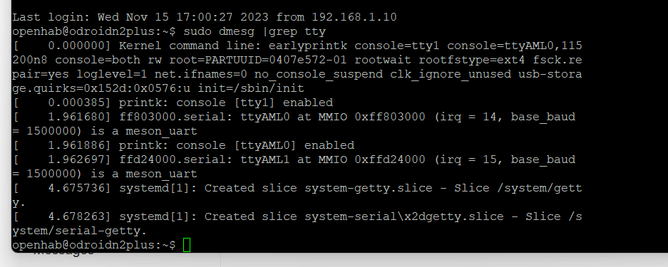

I have this two serial ports onboard :
but under OH4.0.4 I’m not able uder ebus.bridge select this serial ports. Sw is still asking for USB serial device :
