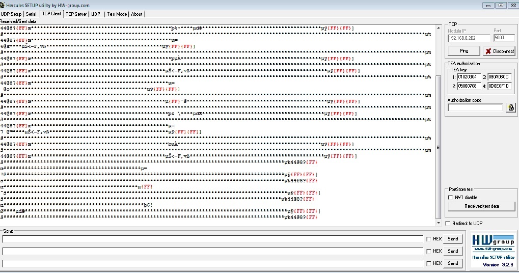

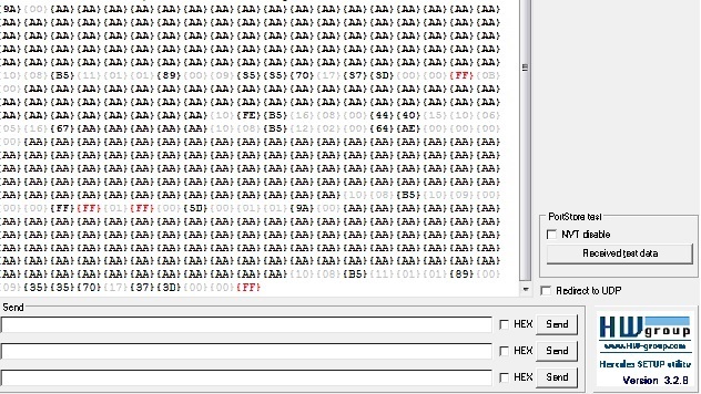

I just started to play around with the binding and the Ebus koppler ethernet, but I’m stuck right at the beginning, I can’t make it connect to OpenHab.
I can ping it’s IP, but the host is unreachable if I put in:
ebus:hostname=jagoebus
ebus:port=5000
If I put in this (its ip) then it comes with an IO error in Openhab.
ebus:hostname=192.168.0.202
ebus:port=5000
The device is set to TCP server.
Any ideas?
Thank you!
Jago
Can you send the error log? You could try to use a program like hterm or realterm to check the connection. If it work you should see many sync symbols (0xAA). If not, you should adjust your adapter.
Btw: Which openHAB version?
Thanks!

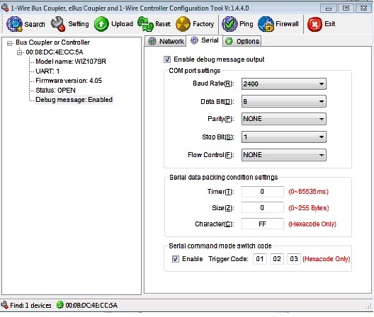

Made it work. Turns out the problem was the setting on the koppler’s serial setting β€œC” was set to FF instead of 00 and in openhab both vrc470 and bai00 had to be set.
For the reference of newcomers:
Ebus Koppler Ethernet (eservice.de) with Vaillant VRC470 and Ecotec Plus, connected to the boiler’s Ebus pins.
Network settings: TCP server
Serial:
Enable debug message output. Leave the fields unchange (2400/8/none/1/none). Time/Size/Character: 0/0/00
Serial command switch mode enable 01 02 03
Options: leave alone
Openhab:
Warning: Only use ebus.hostname or ebus.serialPort
ebus:hostname=192.168.0.202 (or your coupler’s ip)
ebus:port=5000
no custom ebus parser set
ebus:parsers=vaillant-vrc470,vaillant-bai00
Items:
Number Ebus β€œTemperature outside [%.1f Β°C]” (All, gGroundFloor) { ebus=β€œid:controller.temp_outside.temp_outside, dst:15, refresh:60” }
Number Ebusb β€œTemperature room [%.1f Β°C]” (All, gGroundFloor) { ebus=β€œid:controller.temp_room_disp, refresh:10”}
This works.
