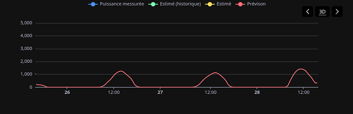

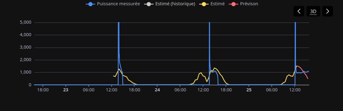

I have a graph with my thermal solar production and via an oh-data-series the futur solar forecast.
I would like to display a personalised period from today (last day of chart 1) to 2 days in the futur (2 first day of chart 2). It’s possible?
char 1
chart 2
Thanks and best regards
