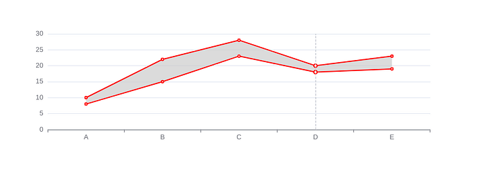

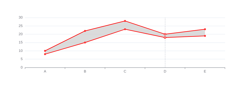

I have a chart with 2 values (a min & max value), and I only want to highlight the area between these 2 lines. This can be achieved with areaStyle - origin (docs), but I don’t know how I can get it to work within OH. I can achieve something by setting this parameter to a fixed value, but this is offcourse not the way to go.
example
