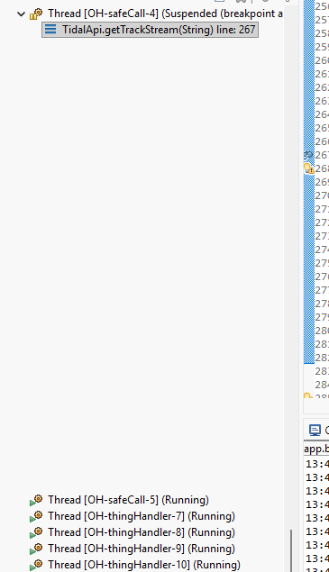

  • Many time, I have to wait several couple of seconds (>30 or 60s) when eating end points before I can do anything into eclipse debuger. Thread displaying is just frost.
  • I’ve also experienced lot of troubles with Expressions windows.
    Display can take seconds to minutes to update.
    When I try to expand complex expressions that contains maps for exemple, the display freeze for long times.
    And even some times, after a few expands, it give me an exception, and have to refresh the expressions Windows, and restart my collections browsing.

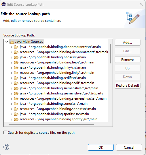

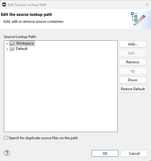

I’ve used to add this source Lookup path:
Using the Restore Default.
And adding all Workspace project to lookup.
As I work at same time on core, and on several addons, this make a quite large lookup set.
I’m not sure what is perfect for this configuration.
But I’ve find that removing existing entries, and adding Working set, Java Main Sources it’s far sufficient for almost most cases. And with that configuration, debugging is working quite instantaneous, no more freeze on displaying backtrace or in the Expressions window when browsing variables !
