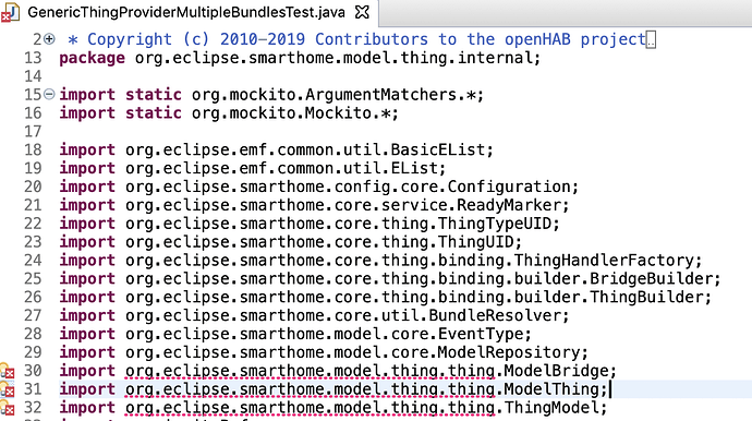

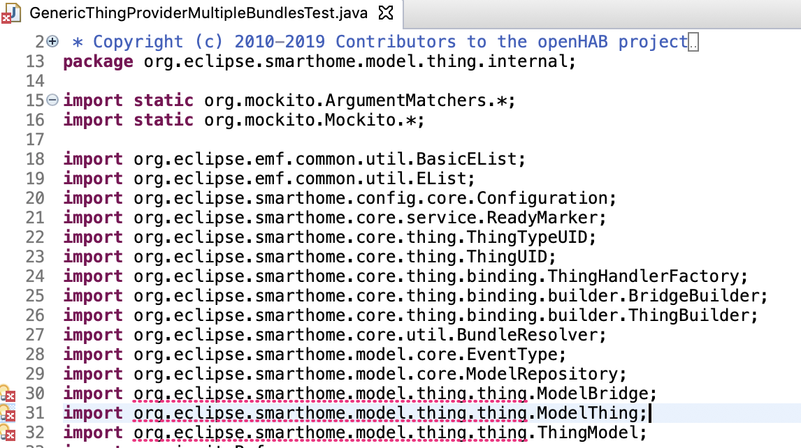

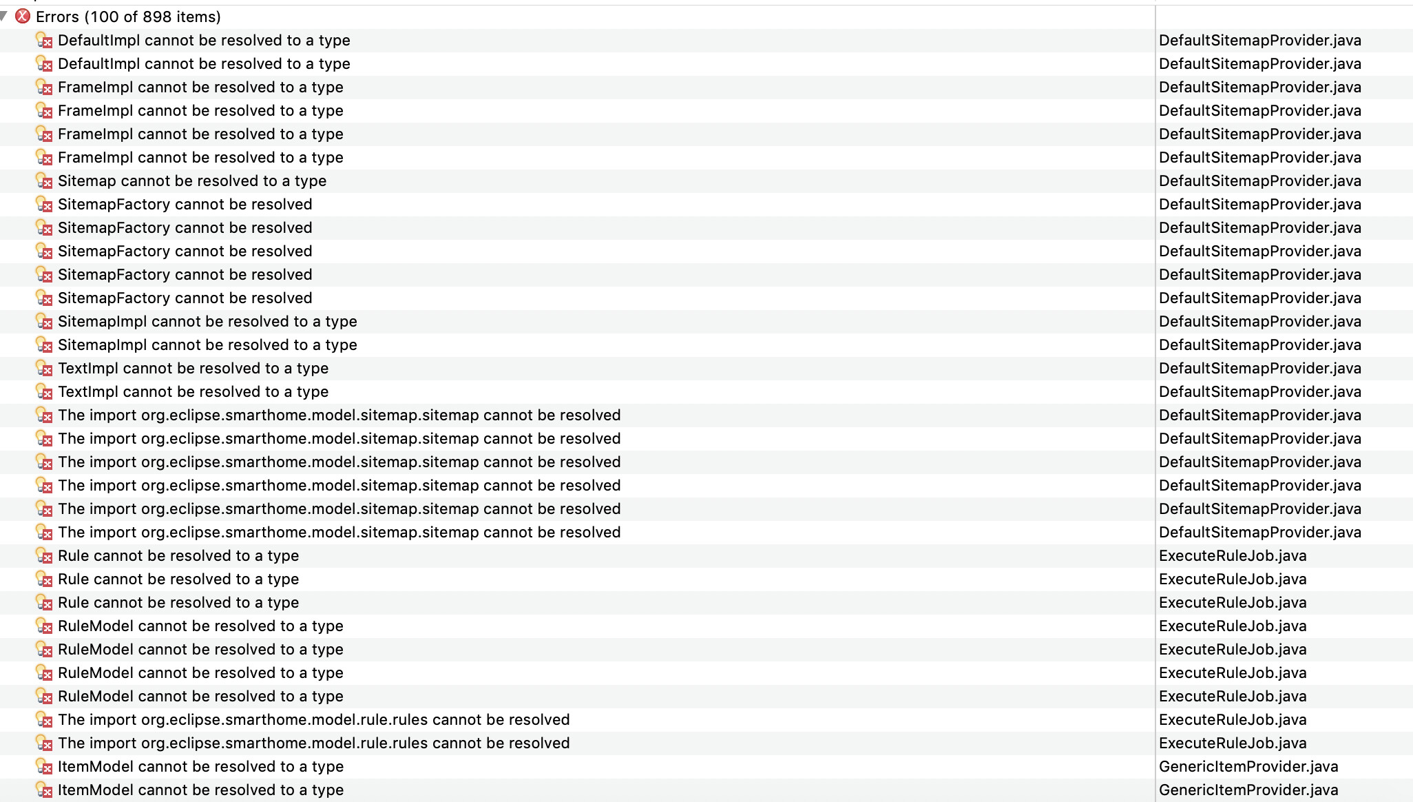

I have solved this issue. I updated all bundles. But after that there are 800 errors, most with type Java Problem, come out!!! Here is the screenshot (part of):
Can anyone help me…?
I haven’t included all of openHAB core, but I think you need to generate the model classes with openhab-distro/launch/ModelGen.launch
I tried to go deeper inside an error class, and it seems that it can not find package in eclipse.smarthome.
So what happened here?
See my previous comment. Did you run the launch file?
