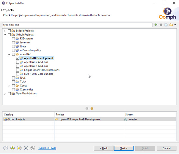

Hi all,
I ran the installer with the options seen below which produced some errors and some more warnings. Would I be able to continue with Eclipse or do these need to be resolved? (I selected all available options for OpenHAB, i.e.the addons, extensions etc)
I have similar problems? Anyone got a solution?
