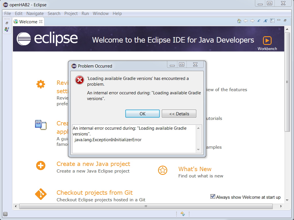

Thanks for your reply. It seems it it due to the JDK installation, I re-install a newer version JDK, after that, the warning window does not appear.

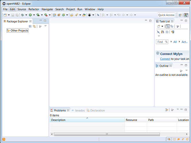

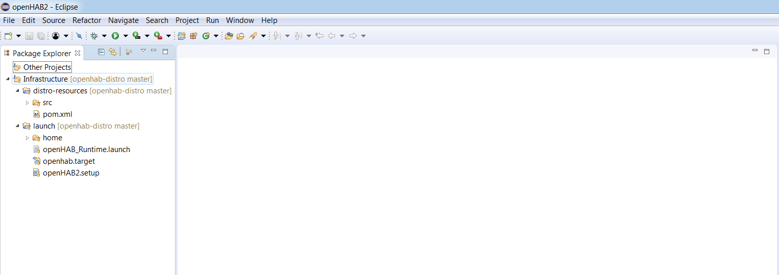

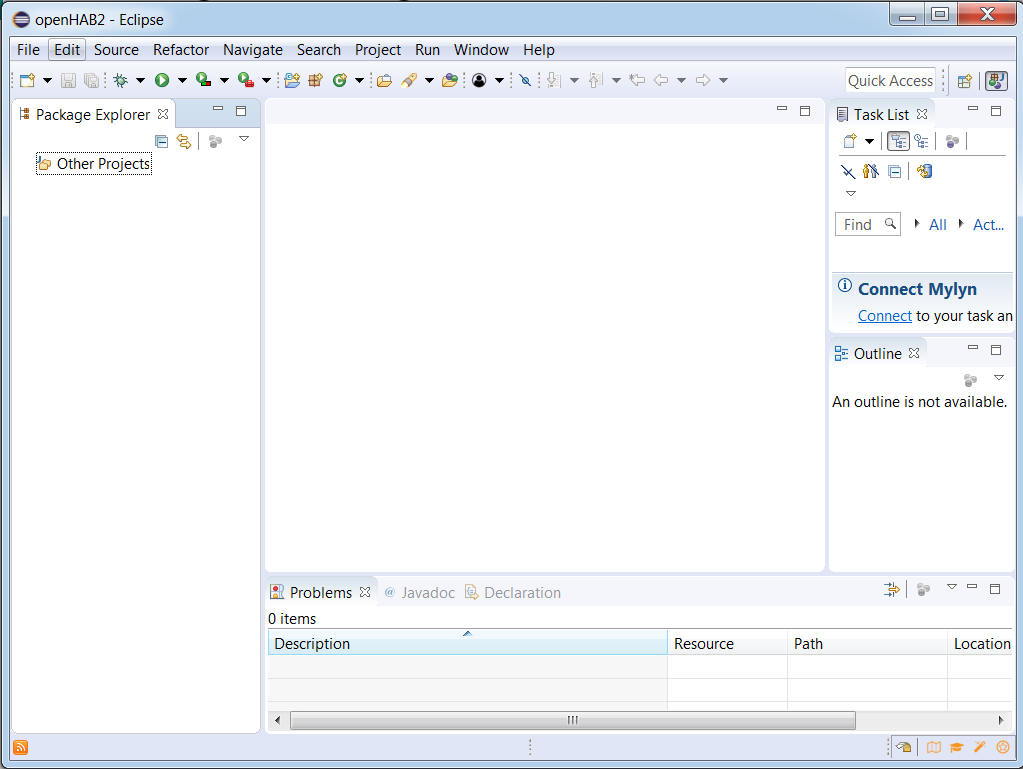

But the result workspace like this:
Sorry that I did not say clear.

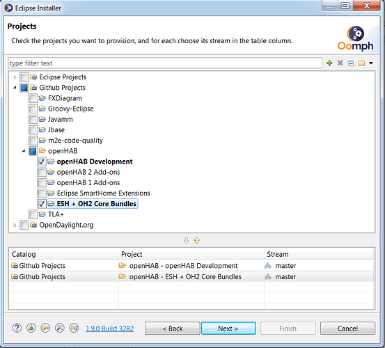

I want to setup the IDE for Developing OpenHAB bidings, but finally, the workspace seems lose something, i could not see the bindings of Openhab.

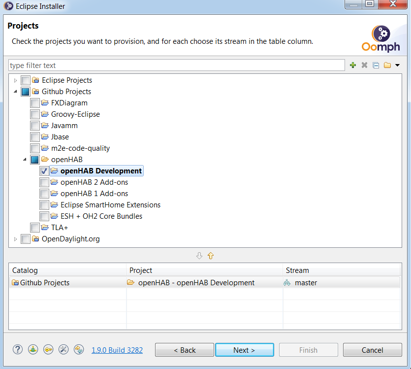

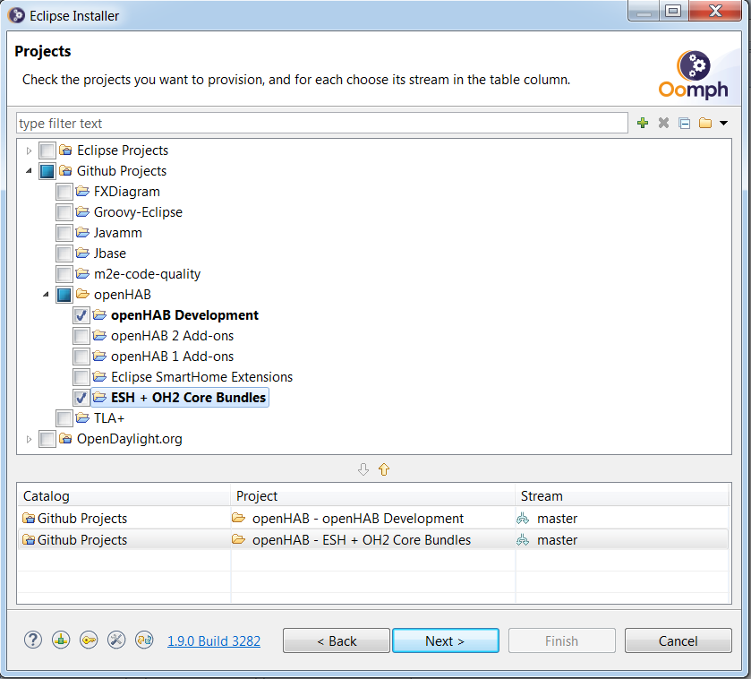

I tried again, and checked the “openHAB Development” and “ESH + OH2 Core Bundles”, and then I can see many bundles in the workspace, and after run it, I can see the openHAB welcome page.

And if you want to develop a binding you must for sure also checkout ( select ) the openhab 2 add-ons folder.
Did you read the documentation?

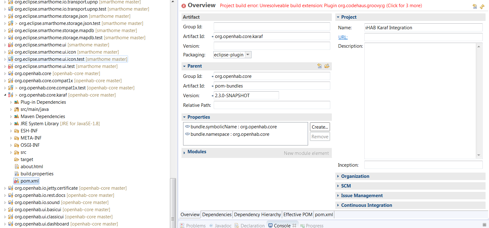

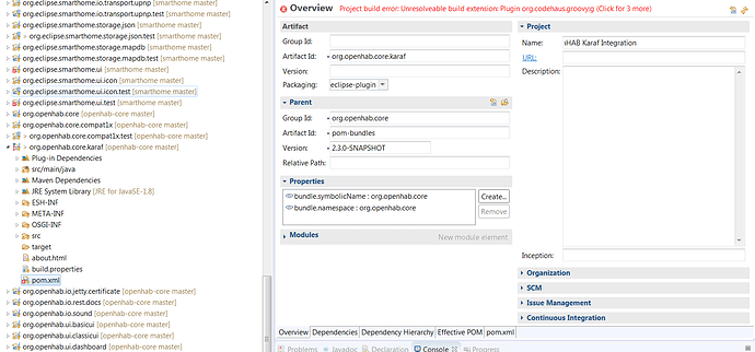

First take a look at the problems tab and check for existing errors. If you see something there after a clean install, do Help > Perform Setup Tasks. If errors remain, try to find them in the project. In my case a couple of bindings were failing to compile for unknown reasons. Simply right click on the offenders and “close project” them
Thanks, It is really relevant to my problem. Previously, I really Intalled many JDK/JRE versions, include Win32 and Win64 versions, and could not set up the development environment.
I removed all the JDK/JRE versions, and do some clean work, then I succeed, thanks:slight_smile:
