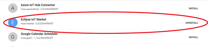

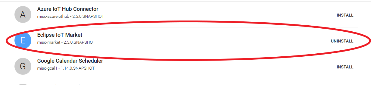

What does “broken” mean? You can still install the Addon from PaperUI in 1589.-1591 and PaperUI also displays the AddOn as “installed”:

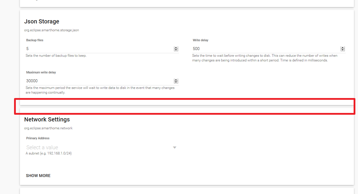

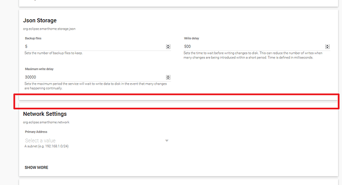

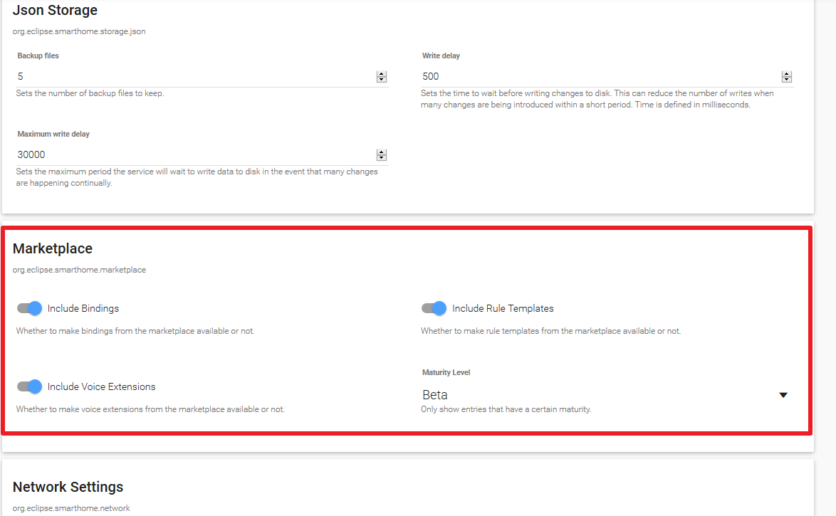

However it does not appear anymore in Karaf Console bundle list and the configuration section in PaperUI is also missing. In 1583, I could find configuration options in PaperUI in Configuration–>System between ‘Json Storage’ and ‘Network’:
In 1589-1591 this section has disappeared:
In 1583 the AddOn showed up in the bundle list in Karaf console:
