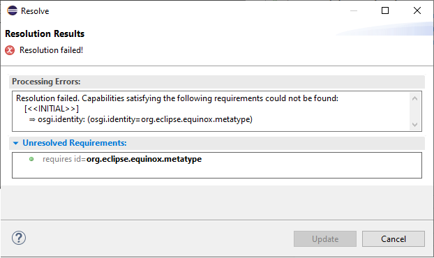

Yet when from Eclipse when I hit the Resolve button I now get this error.
Tried several times, with different order, but the error is still there.

As the dialog shows it is a Bnd bundle resolution issue. It tries to resolve it as it is a requirement in app.bndrun :
-runrequires: \
	bnd.identity;id='org.eclipse.equinox.metatype',\
But for unknown reasons that fails on your computer.

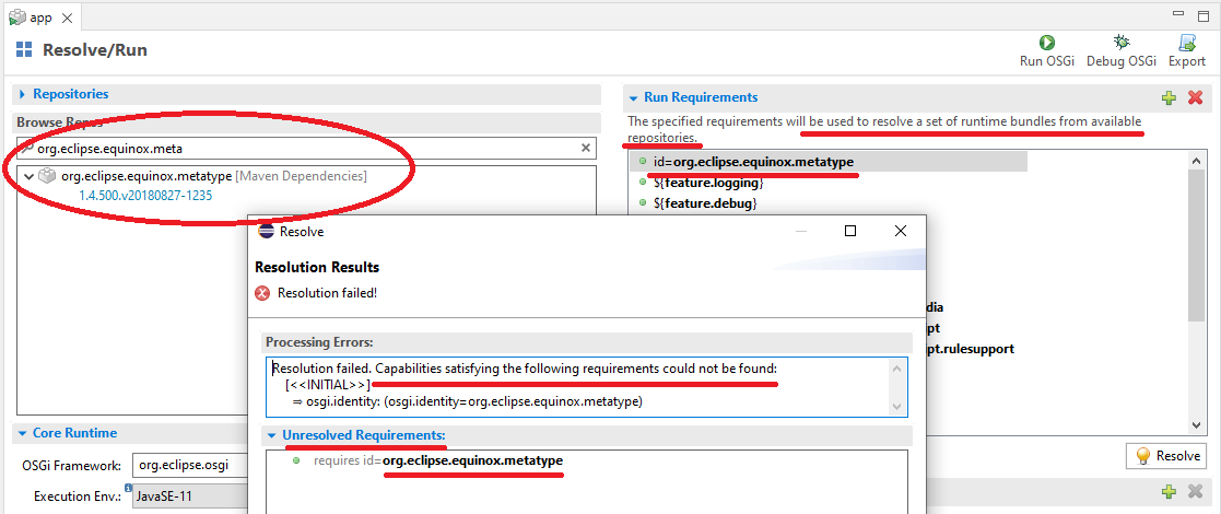

The frustrating thing is that there is apparently no reason and nobody here is able to understand what the problem is. From the following picture it seems bndtools for Eclipse is badly broken: it does not find a Run Requirement (list on the right and error message) while the same tool explicitly declare as available in the looked-up repos (list on the left).
