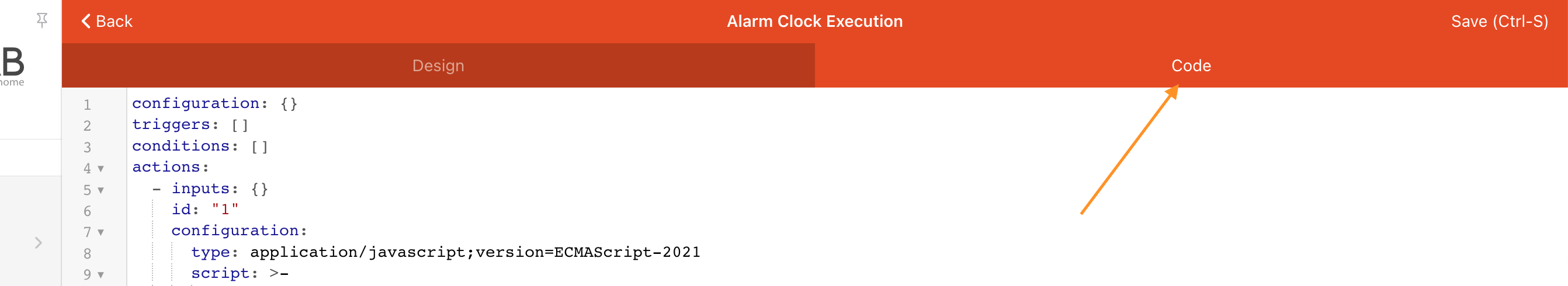

I assume you are referring to the JS Scripting add-on version of ECMAScript. Note, you’d need to install this add-on yourself (it’s not the default) and you’d need to change the script type from “application/javascript” to “application/javascript;version=ECMAScript-2021” on the code tab.
But what do you mean by you’d need to change the script type from “application/javascript” to “application/javascript;version=ECMAScript-2021” on the code tab?*
Where do I find the code tab? I’m a newbee to this scripting language.
