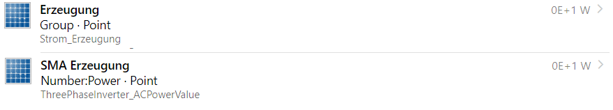

The item in question is type Group with a Sum aggregate function of base type Number:Power:
The group only has a single item at the moment, which is ThreePhaseInverter_ACPowerValue.
I’m trying to compare the number of the item’s state to a constant, say 300.
My problem is that the item’s state is not “0” (zero) but “0E+1 W” and this can’t be used in a ecma script like this:
