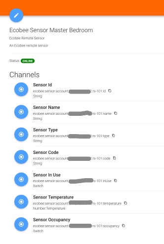

Lastly, the sensors all starting to come through … but I only see the channels that are related to motion detection it looks like - nothing that tells me that actual temperature in each room, which is my main interest.

The sensor channels are created dynamically based on the capabilities of the sensor. When you look at a sensor thing in Paper UI, you should see something like this.

Thank you - I “spoke” too soon at that one … they took a while to come through but about 10 minutes after I posted they now show up.

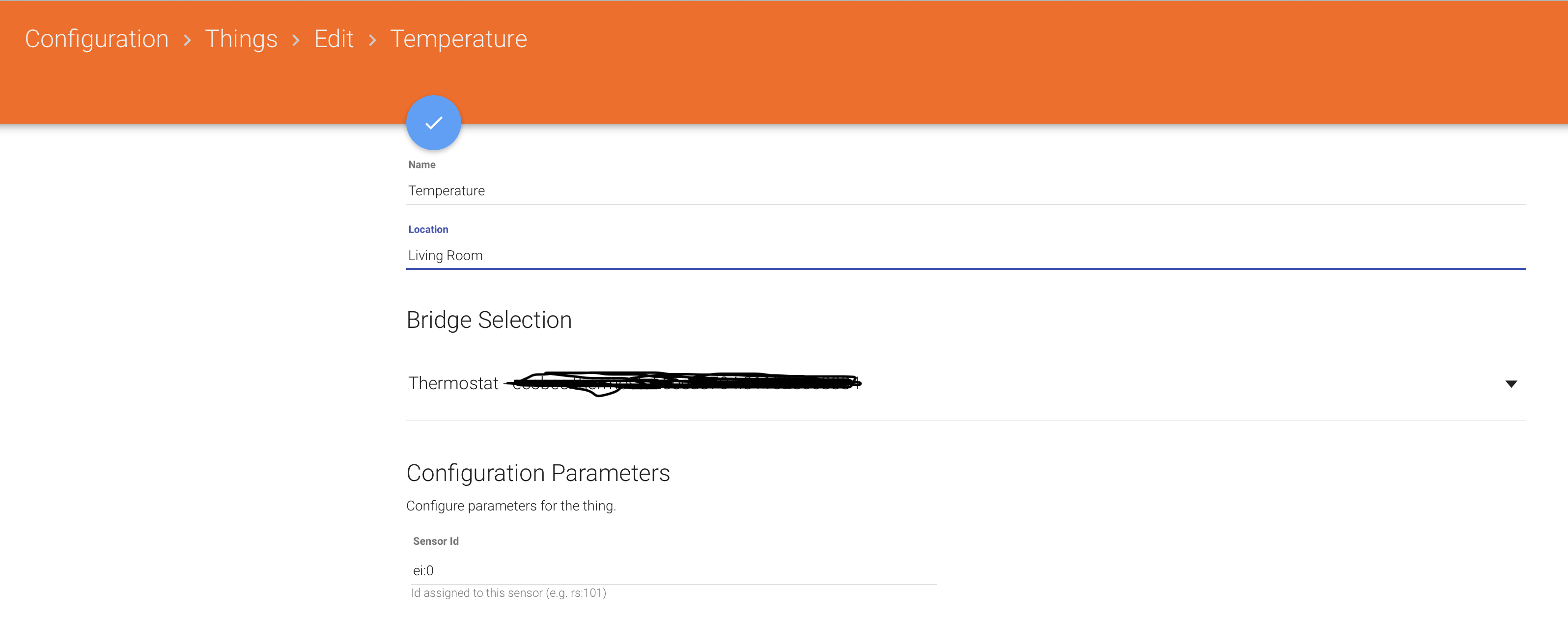

Appreciate your patience :). Yes, in the actual thing I’m setting locations (which for now I’m using to represent the room the device is located in). When I set the location inside the thing it doesn’t accept it and I see an “INTERNAL: Error 500” pop up in the bottom right corner.
I’ve attached a couple of screenshots - wasn’t able to capture the 500 error in the screenshot. In the second example, I’m putting “Living Room” as the location and when I save it that’s when the error pops. I’ve checked the logs so far and found nothing - probably looking in the wrong place though.

Is it only the sensors where you see this problem? I can set the Location on my Thermostat things, but not on the sensor things. When I try to set the Location on a sensor thing, I get the same error as you. Looking in the browser at the response from openHAB, it complains about a NullPointerException. Unfortunately, it doesn’t give any more clues, and I don’t see a full stack trace in the log file. It may have something to do with the fact that the sensor things are dynamically creating some of their channels.
Thank you - yes that’s exactly correct. Please let me know if I can assist … at this point I’m lost :wink:
This is exactly the problem. Once the dynamic channels (e.g. temperature, occupancy, etc) are created, I believe the thing is no longer considered managed by openHAB core. Only managed things can be updated. So-called unmanaged things can’t be updated.
Updating the Location worked when I did it before the dynamic channels were created (there’s a brief delay between when a sensor thing is added and the dynamic channels are created). Updating the Location failed after the dynamic channels were created.
Sorry, but I don’t think there’s anything the binding can do about this.

I was going to look at the issues list for openhab-core to see if there’s already an issue. I’m actually a little surprised this hasn’t come up before. I suspect the check for managed versus unmanaged is binary, which leaves no wiggle room for an edge case like this.
@pstewart19 FYI we’re working through this issue.
@pstewart19 The problem has been fixed in openHAB core, but the fix is in version 3.0. I also pushed a change to the Ecobee binding that will prevent the problem from happening in 2.5. My change will be in the 2.5.5 release.
