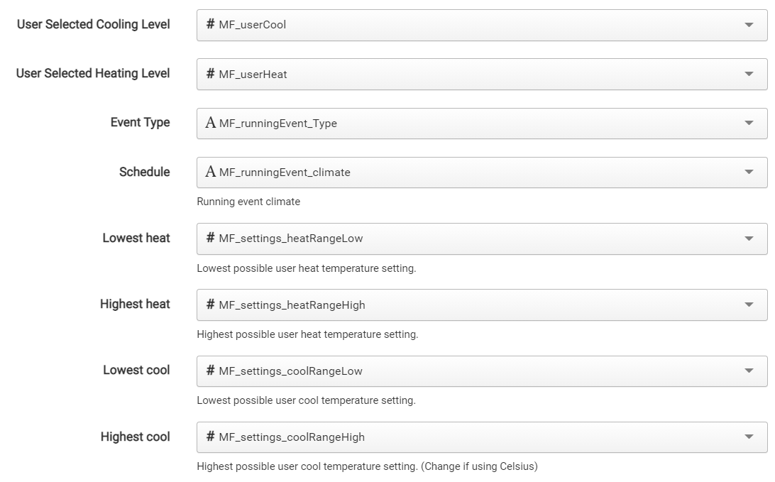

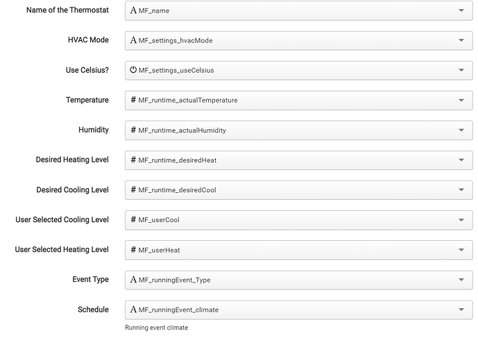

Here’s my Ecobee Items and Rules if this helps. Running Ecobee v2.x also on OH 2.4.

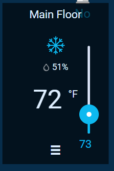

Here’s the screen shots of my habpanel gui and the fields it uses.
Best, Jay

In the rules you posted above, you’re only calling setHold when you update MF_UserClimateRef. Does it create a hold when you alter the temperature at all?
Yes, when I change the temperature it does put it on HOLD by default.
Best, Jay
How?
You don’t seem to have any rules that use MF_userCool or link it to your thermostat. Only rules that set MF_userCool from MF_runtime_desiredCool.
Correct. I did a search on MF_userCool and this is the ONLY place it’s located in the rules. I have 1 rule file for my entire OH with 40k lines of code.

So how does that value get sent to your thermostat?
To be honest, I used Mark’s rules he sent me back in December 2020. I’m really not in tune with the logic of his Ecobee rules. You have everything I have. I actually have 2 Ecobee’s and I have the same logic for both of them.
Best, Jay
There must be something else going on. Based on just these rules, I don’t see how adjusting the temperature is getting changed on the thermostat itself. The only action being called is changing the climate ref, and changing the fan to run all the time. Also, this looks like it just sets the fan to run constantly:

But how does the temperature slider in habpanel update your thermostat? Nothing in all of this appears to do that.
