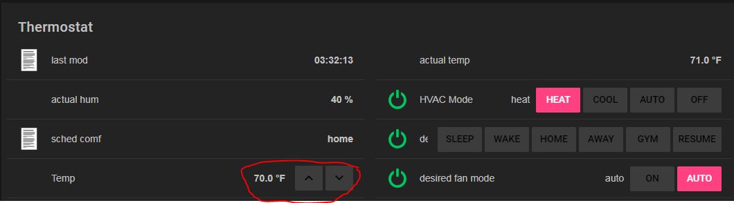

Hi, I have everything working besides the Temperature hold. Once the temperature is adjusted down or up, it does not get updated on the ecobee with cool or heat. I have spent many hours on this and am getting no where. Any advice would be greatly appreciated.
I am running openhab 2.3 snapshot build 1242, ecobee action 1.12 snapshot, ecobee binding 1.12 snapshot.

Everything is works besides changing the desired temperature from the setpoint switch. It does the same thing even if you switch it to cool and change the desired temperature.
This is what it I’m going for…

Hi Mike,
Your rule was not working for me either so I thought I must have messed something up…
I was always testing on the computer with google chrome with basic ui which is the problem. Everything works fine with the android or apple app.
So IE doesnt load too great and chrome doesnt provide the correct setpoint data.
Thanks for all your help getting me on the right path Mike.
