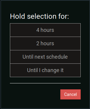

Asks user how long to hold for on click
This depends on our thermostat setting

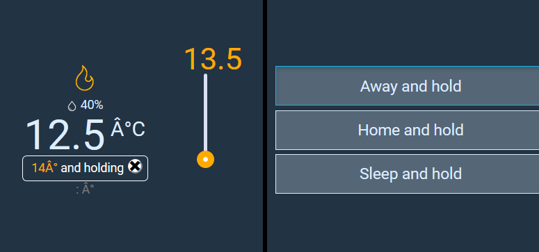

Is anyone else having issues with this widget? When I try to change to a setting, it doesn’t do anything and my log file says "Referenced climate must be a existing and valid Function: setHold
Also, is anyone else having an issue with the main widget showing special characters?
In regards to the quick settings did you change any of the item names when you added them to your item file?
Do you have the ecobee action installed as well as the binding?
