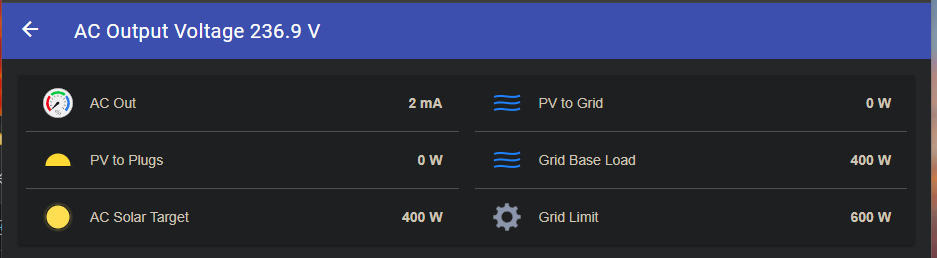

I feel it as ground breaking news, that auto integration is posible, as i see it takes way too much time to integrate devices and then i don’t bother unless there is something as exciting as Ecoflow gear, and then also i used AI burned it into the ground with data limits, as it makes misktakes, then i fix some and stuff it into another acount to finally get results i wanted, and then i customized it to finally get the dasboard bellow.
Sitemap River 2 max
Sitemap Ecoflow Solar inverter

I was working on integrating the Ecoflow PowerStream balcony solar system, and i am happy to say the API bridge i wrote is multi purpouse it works with any type of Ecoflow device, but it supports only one device per service, so for more devices i run more services.
In the meantime i also installed Shelly EM3 so it can monitor excees power, and then trigger Ecoflow River Max Powerstation to recharge with solar power over gird connected power cable.
My API bridge is now able to read all status metrics, but unable to send commands to EcoFlow cloud API, and i was looking into HomeAssistant Integration GitHub - tolwi/hassio-ecoflow-cloud: EcoFlow Cloud Integration for Home Assistant on Github.
So i fired up Home Asistant to test it out.
I don’t understand how all the scripts interact in HA integration, but it is working, i tested it in my HA VM.
So i was not able to modify or rewrite the python code to get commands going from my MQTT broker to EcoFlow API, not even with help of AI.
Server complains about some wrong commands, as it expect complex json.
So is anyone interested and skiled in python for exploring the HA integration to get it working with MQTT and OpenHAB?
For now i made simple automations in HA to trigger battery charging with excess solar.
It goes like if exporting 150W, start charging at 100W to 90% and if no export for 30s postpone charging wait on 65% limit.
Then i have the cloudy weather version if solar production is over 100W maintain 75% and if solar drops below 30W wait at 60% battery.
As charging requires no relays switchin it can be ofset quite often.
Are ther any ideas for optimzation of charging logic?
