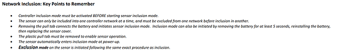

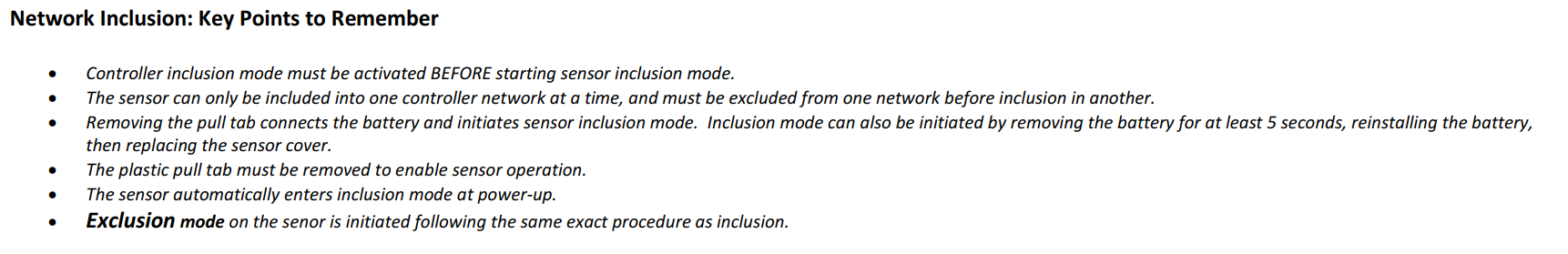

Did you try removing the battery for 5 sec?
Edit: Upon further reading I think removing the battery only applies to inclusion mode.
Here are the instructions from the manufacturer on the zwave alliance site:
Factory Reset:
To restore this sensor to factory default settings, follow the instructions for product exclusion which will reset the sensor upon completion of the process. Use this procedure only in the event that the network primary controller is missing or otherwise inoperable
.Exclusion:
Once the controller is in exclusion mode, simply remove the battery isolation tab, OR insert the battery, OR press the small button on the back of the Motion Detector.
