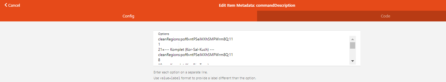

  • Issue of the topic:When I probe add Metadata to ITEM with commas GUI force NEW LINE
I use THINK ROOMBA and ITEM for manage roomba functions
In documentation is ( iRobot - Bindings | openHAB )
Cleaning specific regions:
cleanRegions:;<region_id1>,<region_id2>,..
but when I build string:
cleanRegions:XXXYYYID;1,2,3 = CLEAN CORRIDOR AND KITCHEN AND ROOM
Then GUI user comma as “separator - new line” than additional parameters.
I probe quoted.. but.. nothing to do :frowning:
( Think → Select Think → MetaData → Command Options )
CODE GOOD FOR GUI PARSER not for ME:
value: " "
options: cleanRegions:pof6vntPSeiMXhSMPWrm8Q;11;1;21=— Komplet (Kor-Sal-Kuch)
—,cleanRegions:pof6vntPSeiMXhSMPWrm8Q;11;8;18=— Komplet (Kor-Bia-Tram)
CODE GOOD FOR ME but not for GUI:
value: " "
options: cleanRegions:pof6vntPSeiMXhSMPWrm8Q;11,1,21=— Komplet (Kor-Sal-Kuch)
—,cleanRegions:pof6vntPSeiMXhSMPWrm8Q;11,8,18=— Komplet (Kor-Bia-Tram)
Different is in commas (,) between numbers.
How to Add metadata VALUE with commas and prevent GUI not give me a error options:
ClenResions:…
1
–Komplet (Kor-Sal-Kuch)
I want add metadata in format ( value=label) with commas in value
1,2,3=LABEL123
now it is imposible - and then it is impossible to use full roomba binding for multi room cleaning
Please Help

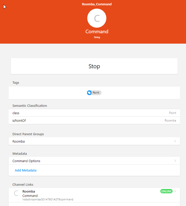

Hi, My fault - I spoke about Item and command chanel
I added a screens
ps. I probe quoted in code config but all genereted errors
2021-11-12 13_49_19-openHAB
Metadata with commas:
2021-11-12 13_51_18-openHAB
in efect i have:
2021-11-12 13_51_27-openHAB
  • its not good
2021-11-12 13_51_44-openHAB
I cant send command to roomba good command ( CleanRegions … room 11,1,21 )
GUI use comma (,) as new line separator :frowning: and I don’t know how to change/quoted ) to not use comma as new line and use comma as separator in command or part of command ( value=label ) when value is a command.

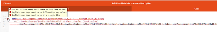

2021-11-12 17_19_33-openHAB
Not work :slight_smile:
I tying many options but in specs of YAML comma is function sign.
GUI also give me a error:
YAMLSyntaxError: All collection items must start at the same column
I don’t use this binding. Do the cleaning commands work if you % encode the comma (%2C)? That will allow the yaml to format correctly, I just don’t know if at any point in the binding’s flow strings are html decoded.
If not then you’re probably going to have to work around this with a simple rule. Make a proxy item and set its commands to whatever descriptive strings you want and make a rule to pass along the true command strings in response to changes in the proxy item.
