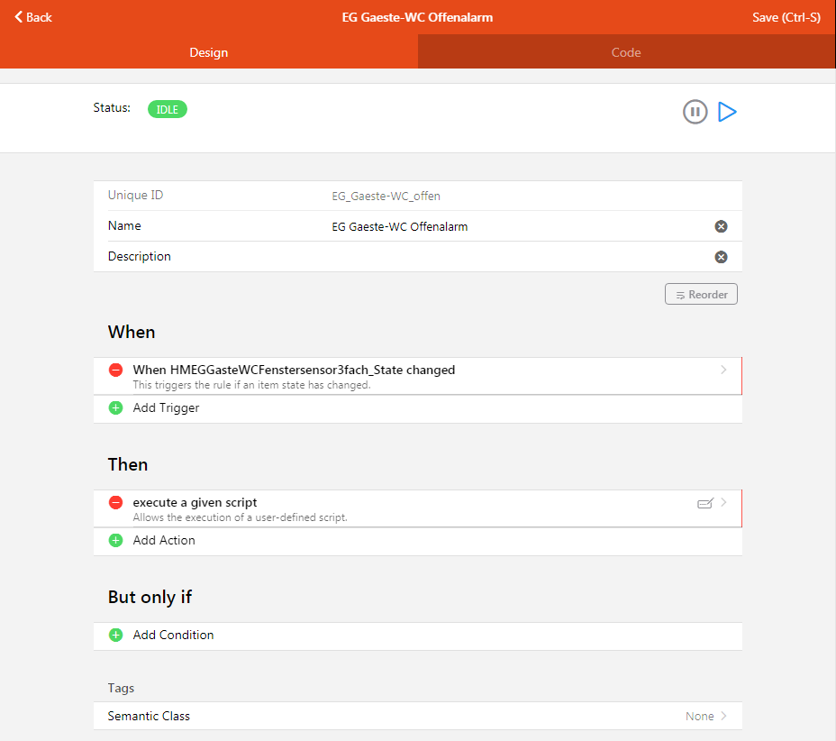

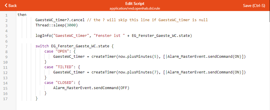

Dear Rich,
thank you so much for this detailed answer. It helped me alot and I appreciate it very much.
My working :slight_smile: rule looks like this in the moment:
rule "Fensteralarm Gäste-WC Offen"
    Item EG_Fenster_Gaeste_WC changed
        GaesteWC_timer?.cancel // the ? will skip this line if GaesteWC_timer is null
        Thread::sleep(3000)
        logInfo("GaesteWC_timer", "Fenster ist " + EG_Fenster_Gaeste_WC.state)
        switch EG_Fenster_Gaeste_WC.state {
            case "OPEN": {
                GaesteWC_timer = createTimer(now.plusMinutes(5), [|
                    EG_Hue_bloom_Wohnzimmer.sendCommand(HSBType::RED)
            case "TILTED": {
                GaesteWC_timer = createTimer(now.plusMinutes(7), [|
                    EG_Hue_bloom_Wohnzimmer.sendCommand(HSBType::GREEN)
            case "CLOSED": {
                EG_Hue_bloom_Wohnzimmer.sendCommand(OFF)

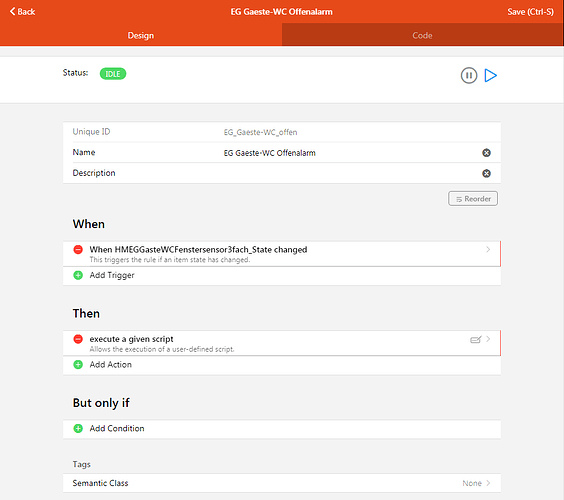

I have no clue how to set this up in OH3. The start is easy:
Then I tried this code:
And checked for the status change of item Alarm_MasterEvent:
Analyse tracks no status change, the event log shows no changes and the rule delivers no errors.
Can anybody help? I would love to do it with Blockly but it seems not to have timers at all.
Thanks,
Timo
There are two problems with the code you tried.
  1. GaesteWC_timer is a global variable. I know of no way to define a global variable like that in Rules DSL in the UI. If you have rules that use a global variable like this, you are better off keeping it in .rules files. This is even more the case if that global variable is used by more than one Rule.
  2. The “then” on the first line renders this script syntactically invalid. Script Actions should not include “rule”, “when”, the triggers, “then” and “end”.
And if you are creating Timers anyway, why the sleep for three seconds?
