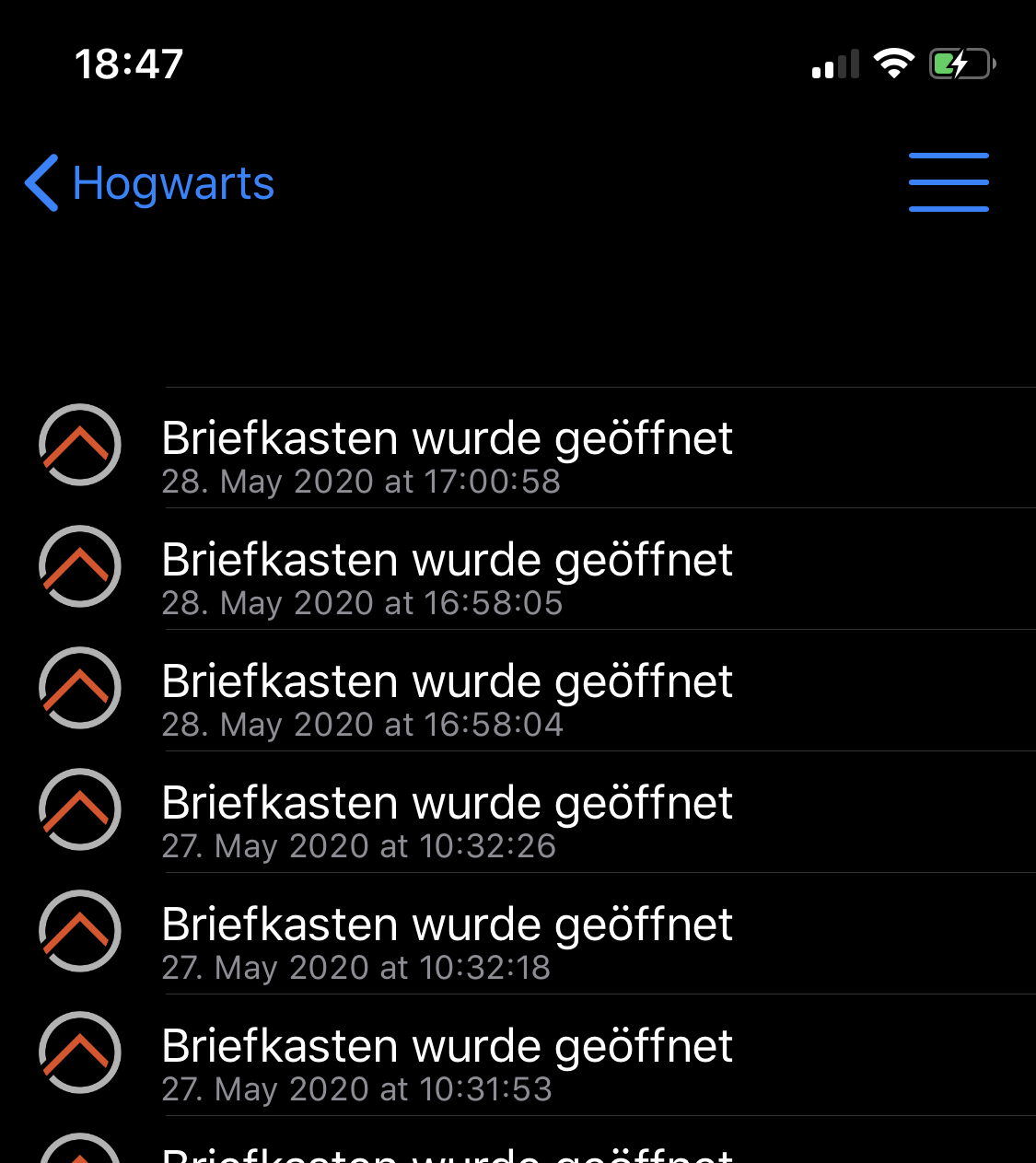

I do have the problem that notifications don’t show up on my iPhone when openHAB Cloud Service is in mode “remote”. They do show up online and within the corresponding menue in the app, but there is no alert.

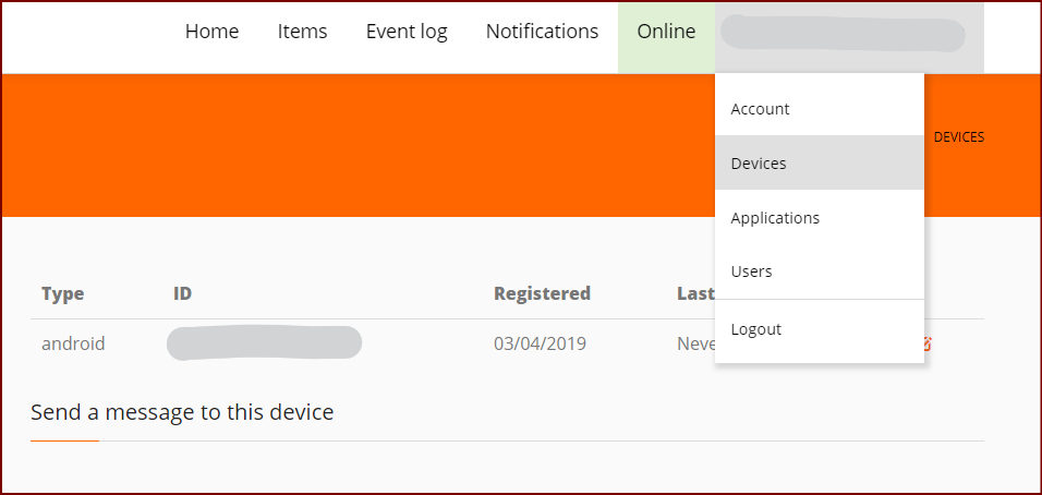

Welcome to openHAB! I haven’t heard of an issue like this before, so let’s start by making sure everything is working between myopenhab and your iPhone. Is your phone registered in myopenhab under Devices? That’s necessary for notifications to work.
You can test notifications right in this screen by sending a message to the device.

The device is shown within devices list, also test messages appear on my lock screen. But when sending notifications via rules, they are only shown in the notifications section in the app.
