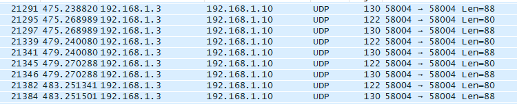

Wireshark shows this:

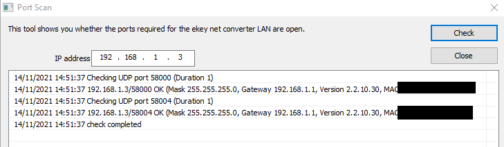

The EKEY software for the converter LAN shows this:

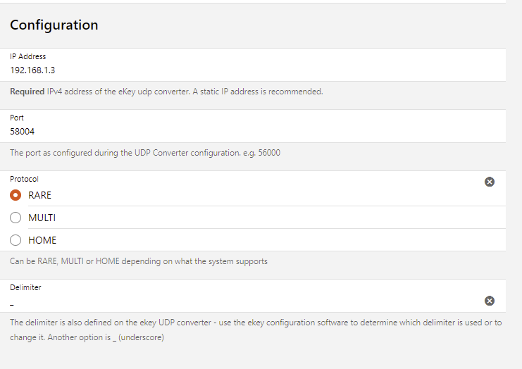

openHAB:
So, if I understand this correctly, the Converter LAN is transmitting on port 58004 and the Raspberry PI 4 (and openHAB) is seeing this.

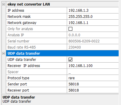

On the EKEY converter LAN screen I cannot set the UDP data transfer Tx and Rx ports to 58004. When I save, it reverts to 58018.

If I get you right, you cannot set the port on CV LAN to the port configured in openHAB ?
This is your issue then, both ports need to be identical. Please try a different combination then.

I really thought I had tried every combination of ports - I was not getting a log entry unless I set the Port to 58004 on openHAB but I just tried 58018 and got RARE data back so thanks!
