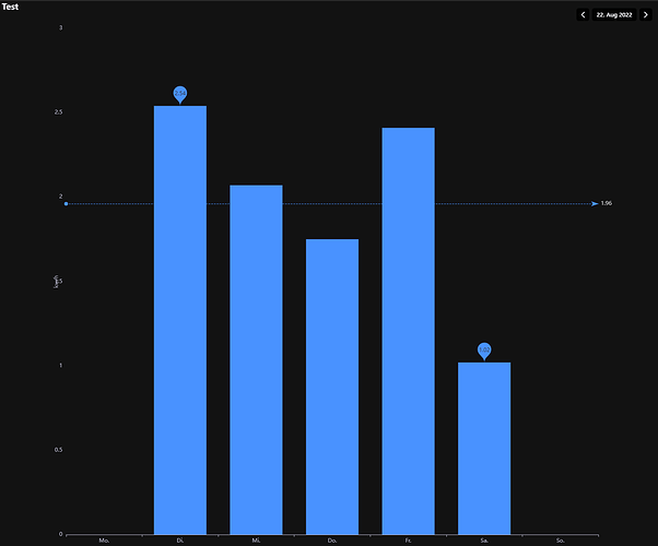

Hi All,
I use OH3.3 on a Rasperrypi4 8GB.
I have an electricity meter that I read via MBus. The meter gives me current consumption values.
Additionally I always get the current meter reading (as Total Number).
My goal is to see how much electricity I have consumed on which day of the week or in the month.
That works also almost everything.
My error, however, is that always the first day / first month, etc. in the diagram is without values (See picture).
I have the data since 04 September about OH3 written.
However, each week is always displayed only Tuesday - Sunday.
In the annual overview (how much I have consumed per month) it is also not displayed.
What am I doing wrong?
Thanks for your help.
BR
Marvin

That should be expected behavior and not an error.
Your aggregation function “diff_first” is comparing any value to the first value in your data. Therefore comparing first day /month of a week with itself is not showing data
Is there a workaround or something like that?
In principle, it is correct that only the difference from the previous day should be displayed.
So if yesterday the meter reading was 2000kw/h and today 2100kw/h it should show 100kw/h as consumption today.

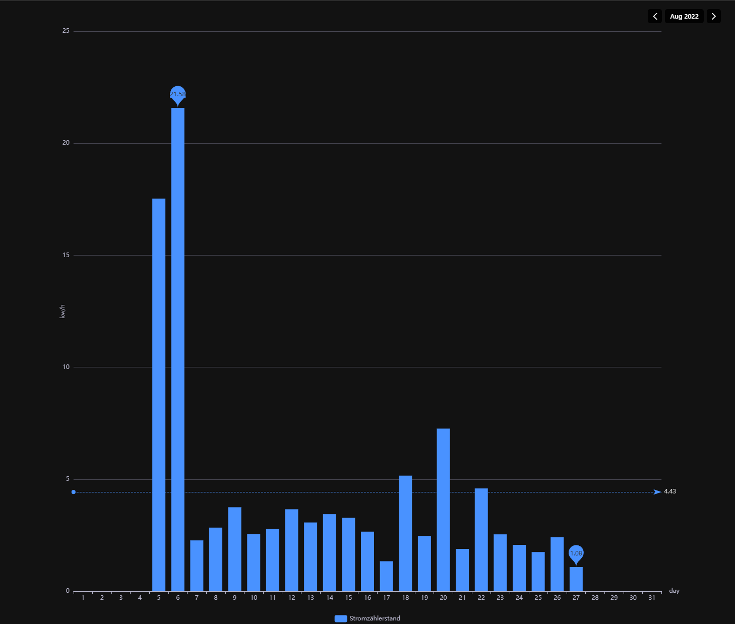

I found a solution
I played a little bit with the offset of the aggregate-series
offsetUnit: hour
offsetAmount: 1

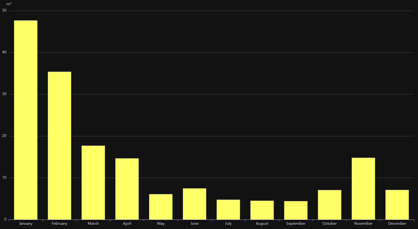

Here is an example for my year chart, and I do the same for a month chart.

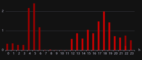

For the daily graphs I use minute as offsetUnit
