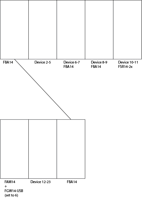

Hi!
I’m encountering issues with the tech-in of the second channel of all my Eltako FBA14. All other devices teach in fine. Another 2-Channel device (FSR14-2x) also is fine. Everything is Connected to Openhab via an FGW14-USB
The address of one of the FBA is 6 for channel 1 and 7 for channel 2
For teaching in the first channel, I set the upper switch to 180 and for the second to 200.
The layout of the system:
