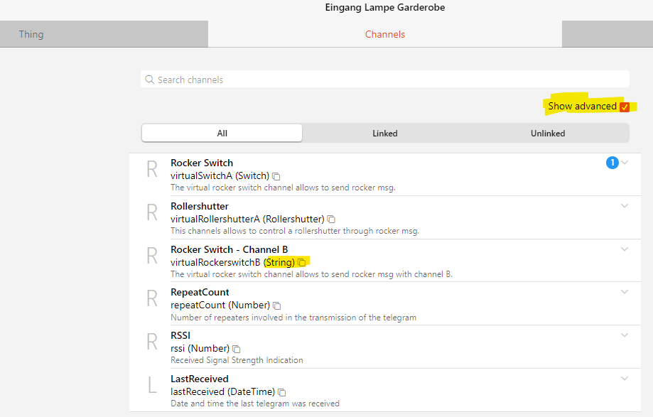

I just can’t manage to control the second channel B of my FMS61. Channel A works perfectly. For channel B I created a virtual RockerswitchB, it does not work with Type Switch nor with Type String as suggested. What kind of string do I have to send to switch on and off?
Thanks for the reply. I am migrating my system from FHEM to openHAB. The actuator FMS61NP-230V has two channels A and B, both are already learned in and work perfectly with FHEM via a virtual rocker switch with the two channels A and B.
For channel A it works correctly with openHAB, while channel B does not respond.
I’m somewhat confused that Channel B is only displayed under "Show advanced " in the openHAB enocean Classic Device and furthermore it is defined as a string by default, in comparison to Channel A which is a switch by default. Do I understand something wrong here?
