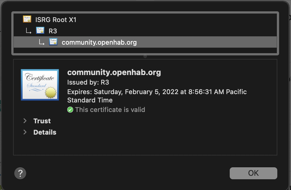

Ok, looks like we had an IPv6 issue and lets encrypt could not route to our forums to verify our renewal. I have temporarily removed IPV6 addresses from our DNS, and was able to renew our cert:
